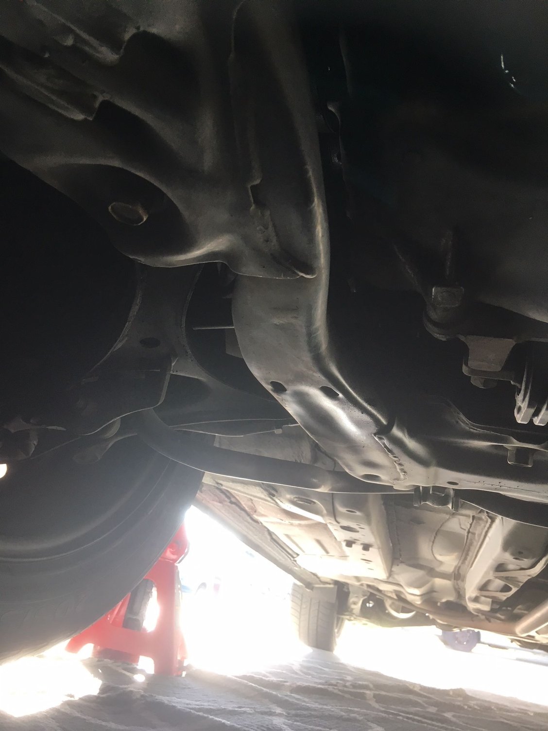

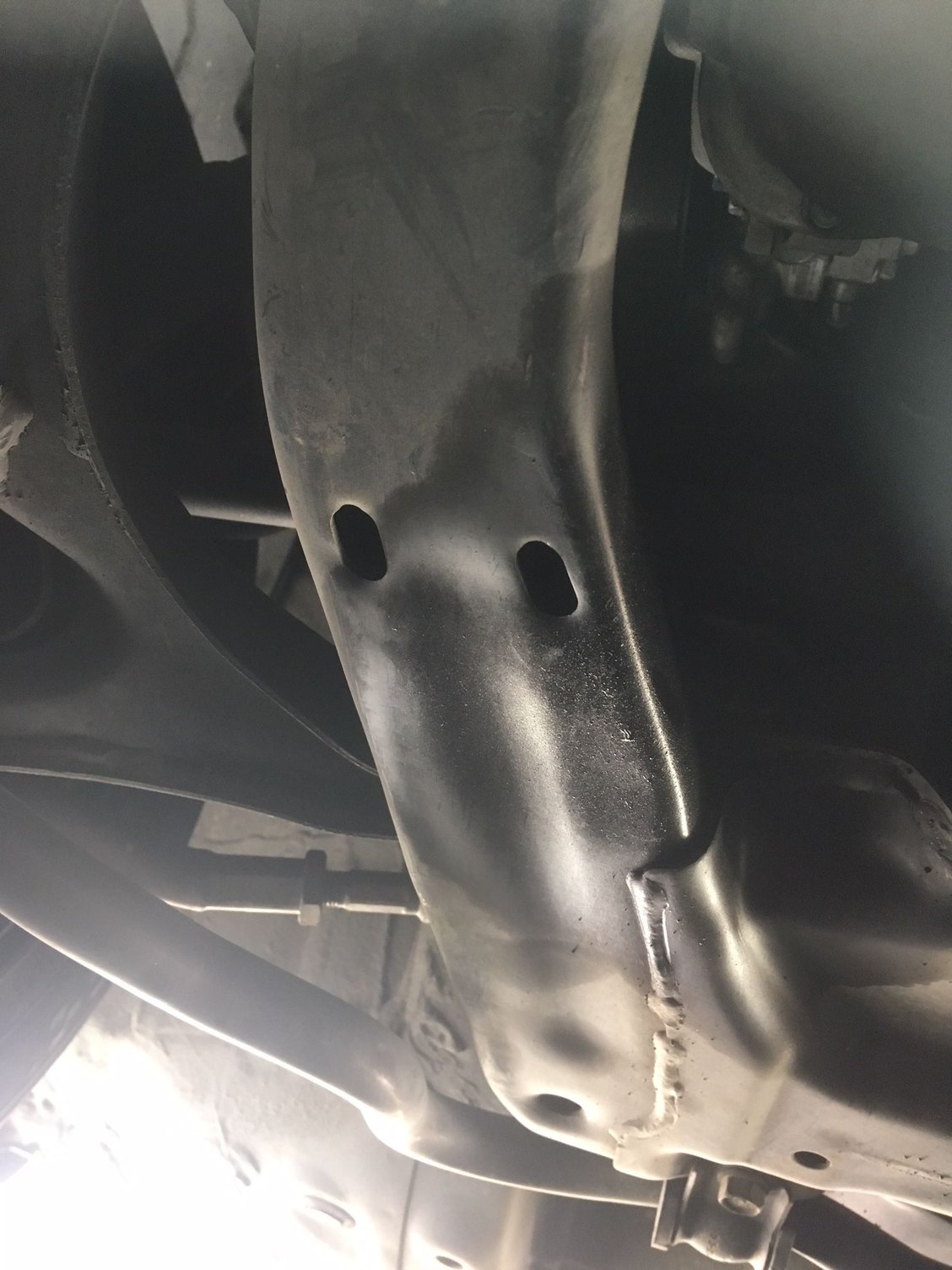

Hi, I am experiencing a leak and I'm not sure where its coming from.
This is right next to the front passenger side tire, it doesn't smell like anything so I'm guessing it's water, haven't used the A/C in a while so I don't think its that either.
Any help/suggestions would be greatly appreciated.

Have you used the defroster? It turns the AC on even if on full heat.

I probably turned it on a few times, I didn't know that hot air can cause the leak as well, thought only blasting the cold air causes condensation to form. Thank you!

When you use defrost it turns the AC compressor on so that it can remove the humidity out of the air and help the window defrost faster.
f you want you could wipe it all down and then check it again in a few days. If it has so smell then it's not coolant and if it feels like water it is not oil.
