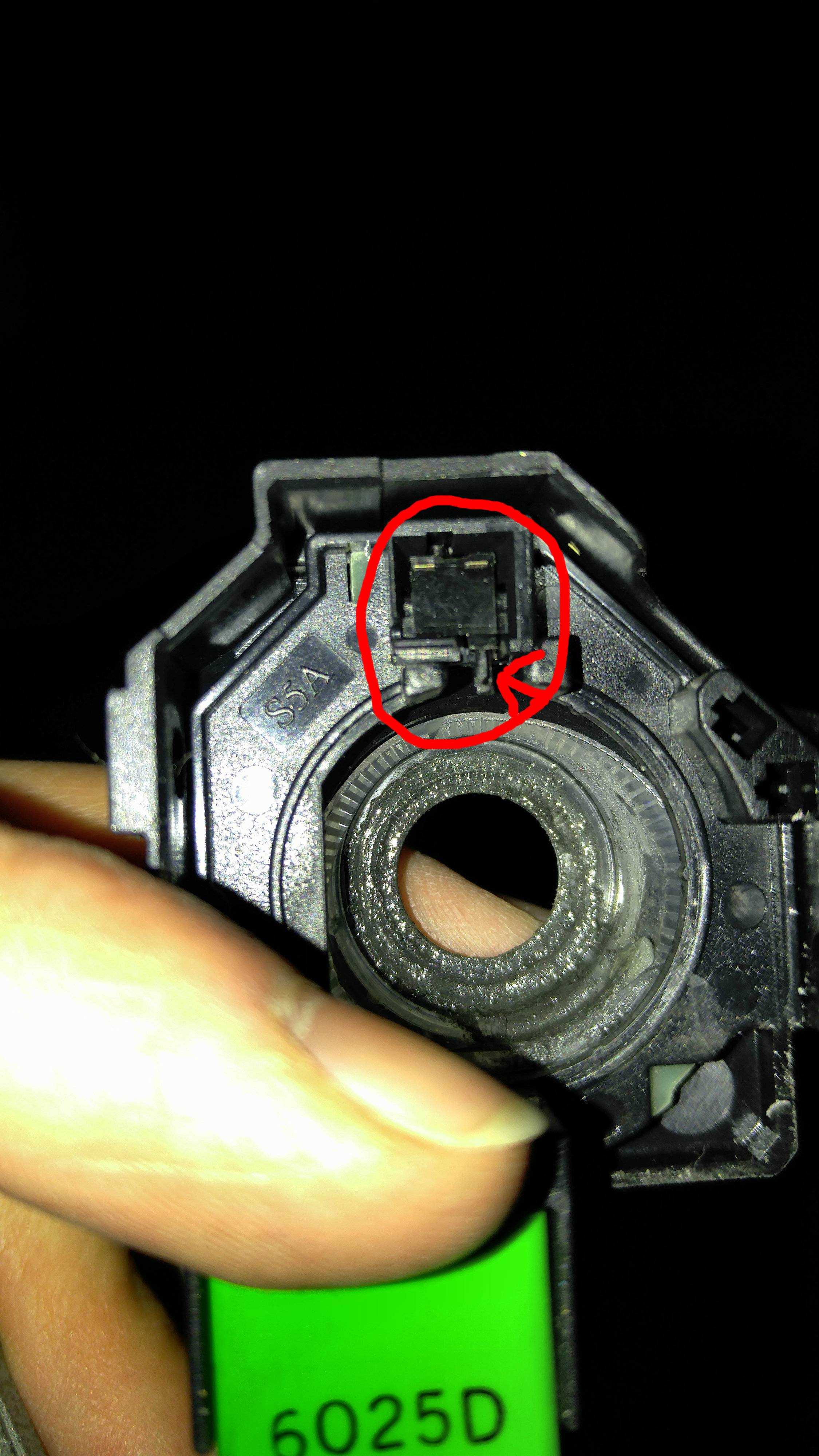

I did some taking apart of the whole thing, and took some pictures.
What I figure is this:
In picture 1, there is a little pin that gets pressed down (up, technically?) that lets the ignition know a key has been inserted.

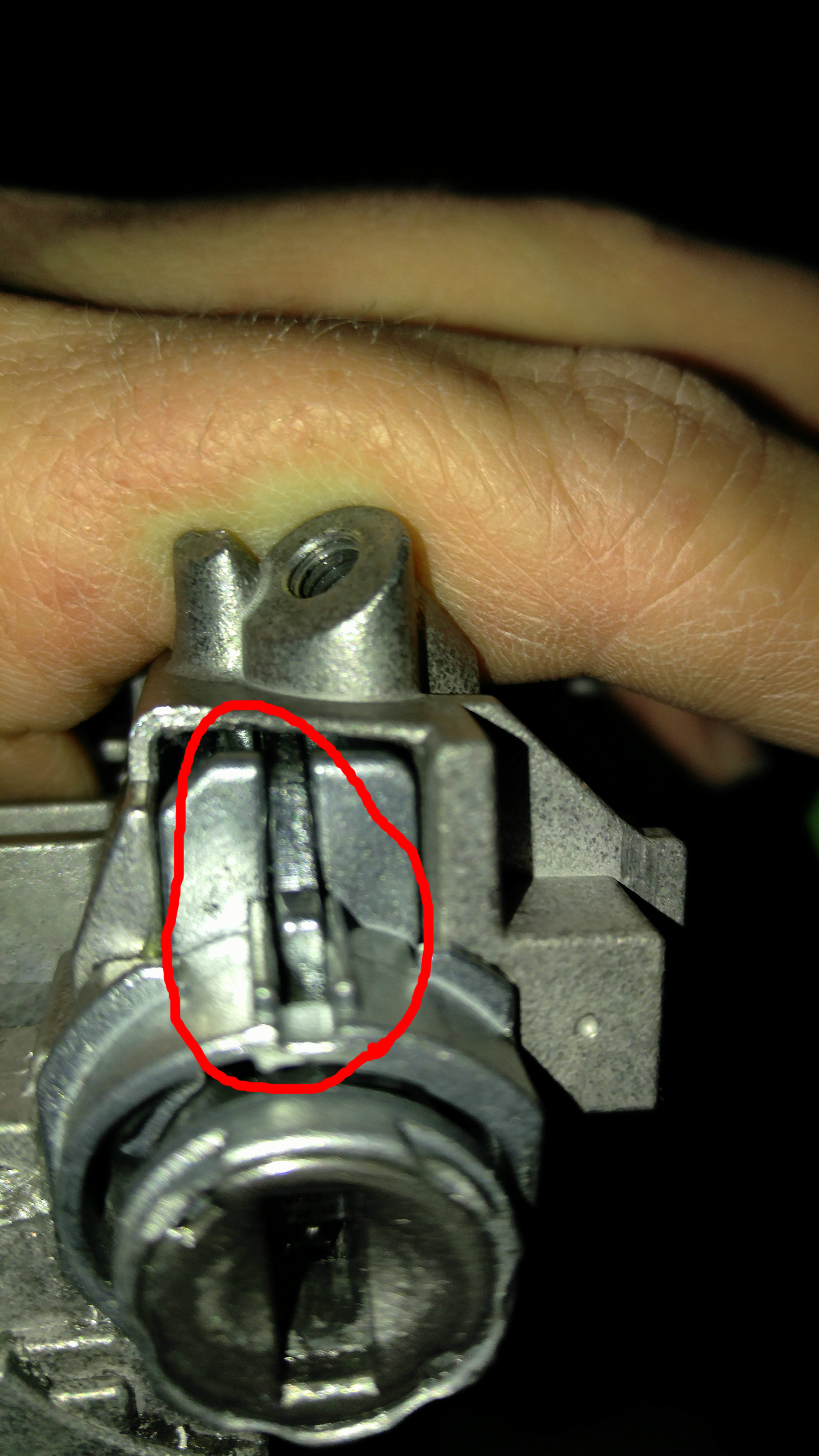

In picture 2, there is a latch that, when you insert the key, I am assuming should spring up, to push that pin in.

The problem, is that latch in picture 2 is always up. Maybe a spring is missing?
Yes, good picture too.
I assume yes, I can't see the rest of the lock and you can..

How would I explain this to the locksmith, with the proper technical words regarding the situation?
Exactly the same as you did here.
That bar or rod (whatever it is, point at it) needs to move the switch (point again) when the key is inserted and removed ---and right now it is stuck up and doesn't seem to move at all. ???
Basically explain the switch is now stuck on all the time because that bar isn't moving correctly. Let them figure out what happened.

Yeah so when I put the key in, it doesn't move. I can press it down, but it springs back up.
