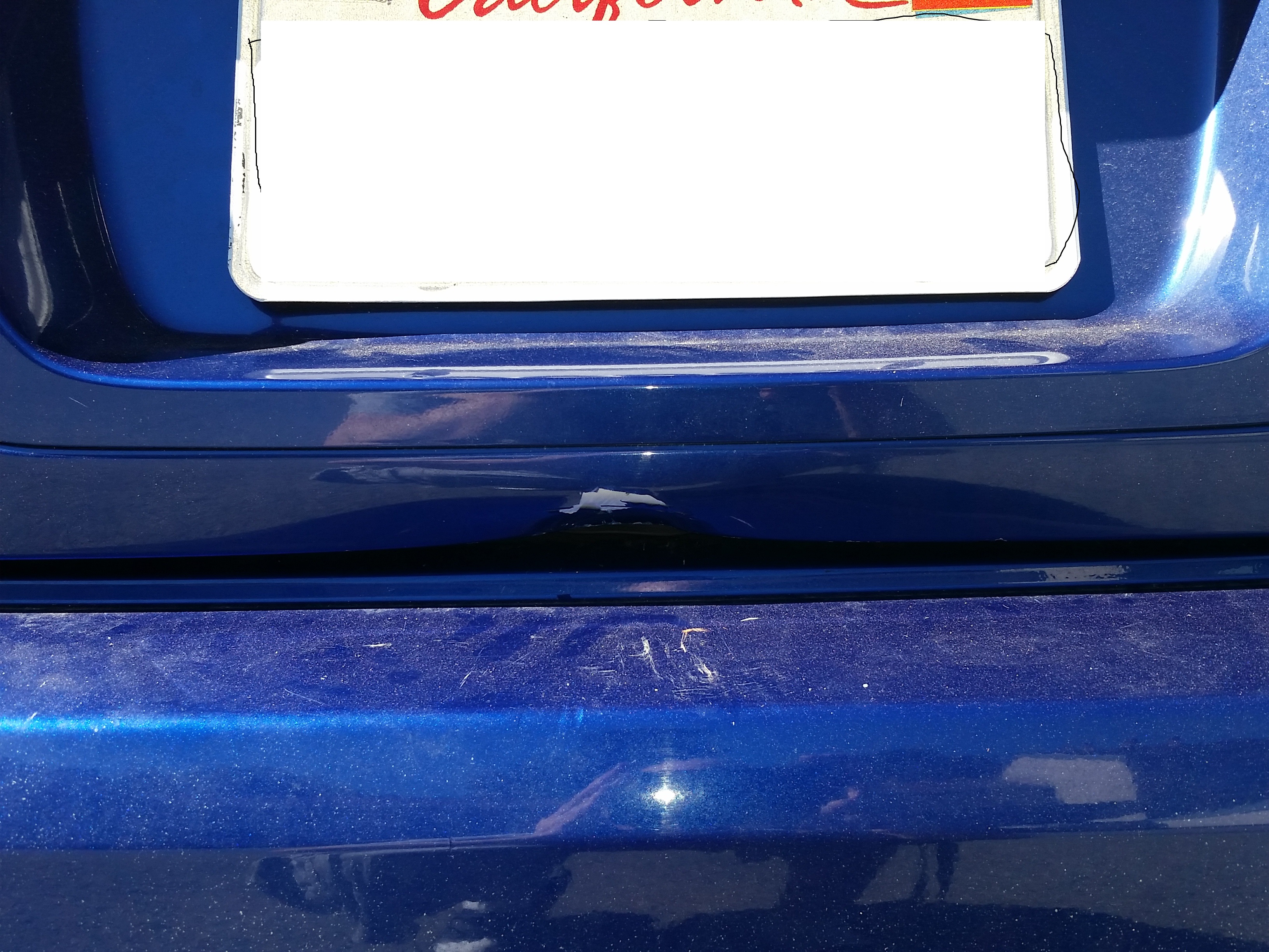

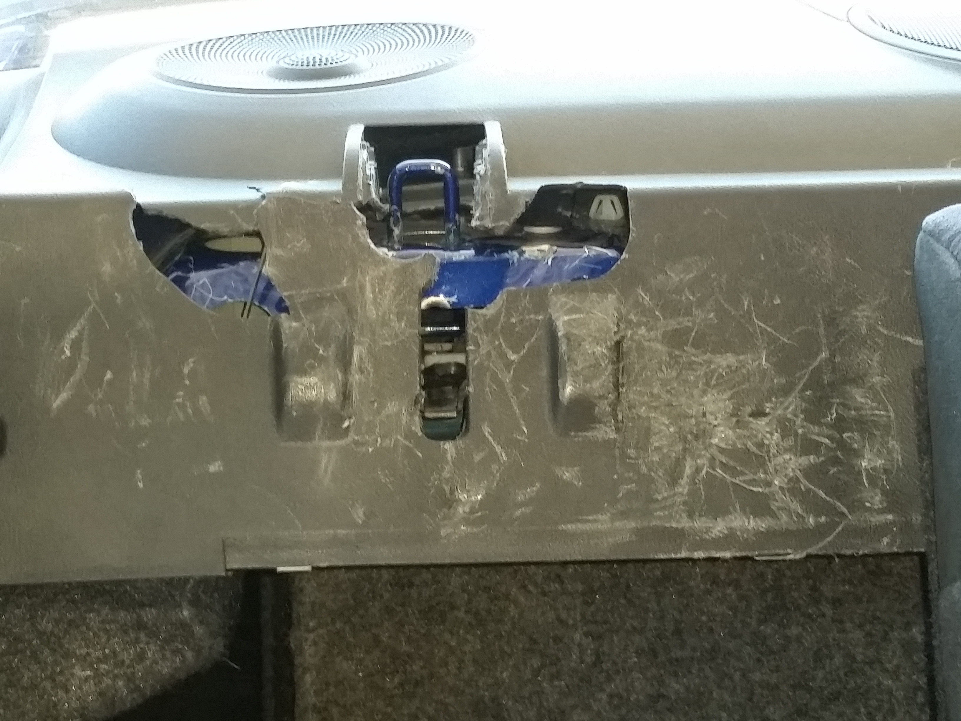

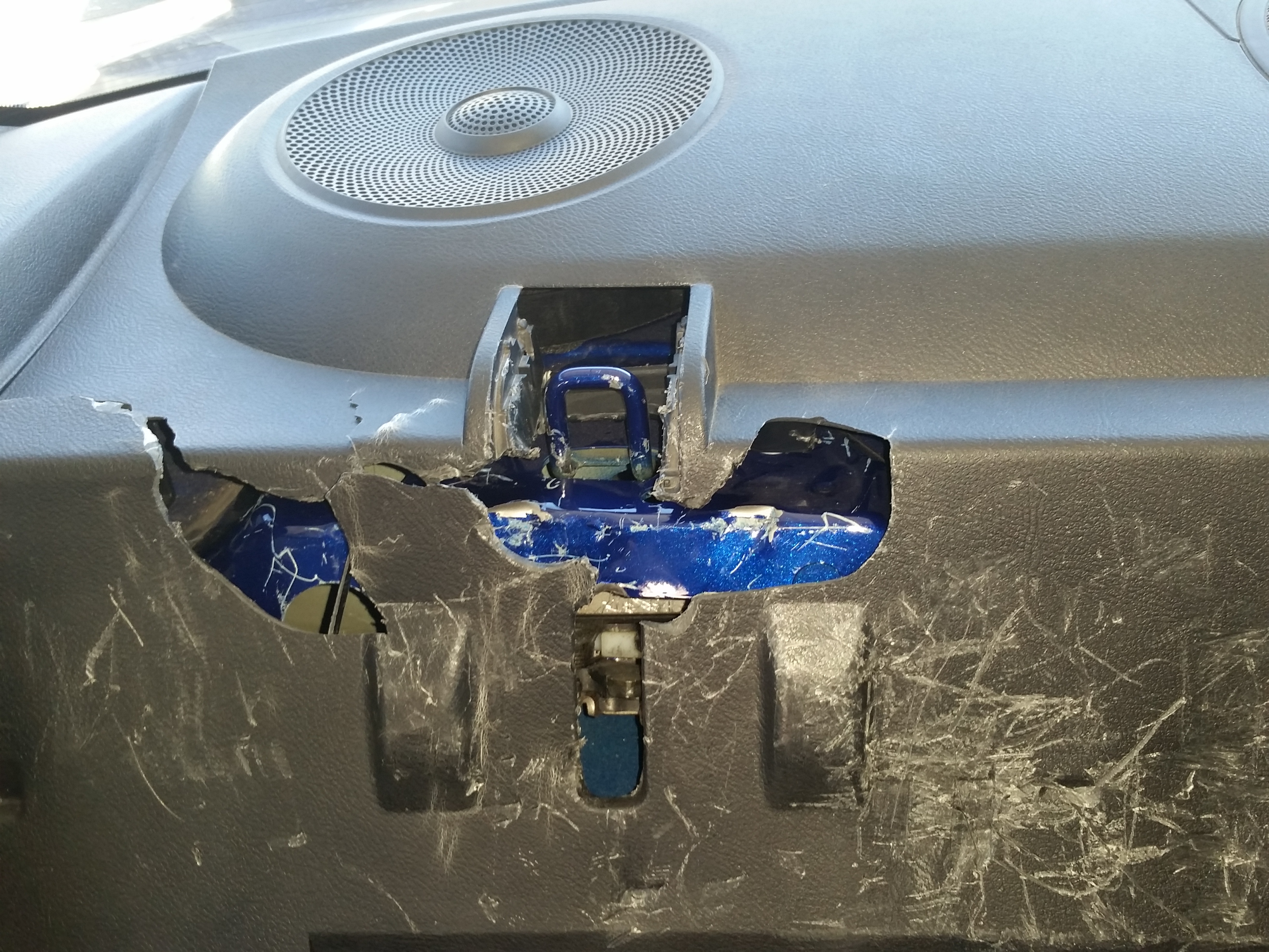

I recently got a flat tire and when i went to pop the trunk to get the spare ...i have had nothing but a headache ever since. My trunk will not open. I have read many Honda forums about this issue, I even took it into a Honda Service center. There is a Design flaw with ONLY the 2006 Civic si 2Dr Coupe they decided to make it Key less entry. Trunk is opened with a button on your Key as well as a latch you can pull on the driver side door. If you think you can get into the trunk through the back seat your absolutely Wrong! unless your stretch armstrong. The Local Honda service center said they would have to cut a hole in my seat... and i would have to replace it $$$ One tech recommended i purchase a "snake cam" and try it that way... After a Phone call to American Honda Corp. They said it is not a safety issue and basically there's nothing they can do to help me. Well... i took it upon myself and took the back seat out.... unbolted a few bolts... to where i was able to part the seats enough to slide my arm through... but couldnt reach the seat latch to make the seats fold down... MAJOR DESIGN FLAW...!!! took a broom stick... and got the seats to fold down. Crawled in the trunk and at the back of the trunk clear as day...EVEN GLOWS IN THE DARK (Emergency Trunk Latch slide to the left) so i slide the handle to the left... and NOTHING... TRUNK STILL WONT OPEN... now i ask you HONDA.... HOW IS THIS NOT A SAFETY ISSUE????? they will fight it till someone dies...from this.... THEY DONT LIKE ADDMITTING DESIGN FLAWS or Coming out of pocket to do a Recall.. Now i know knot everyone has had this Problem.... but i asked Honda if trunks just go out... they said Yes.... WELL then what the **** is that Emergency Latch for? Please indulge me with your response of bs.... i cant wait to hear it... The Pics below are the damage i did just to get inside my trunk.... to attempt the Emergency Trunk Latch. Trunk is Still not open to this day! on Honda's Customer Service

So... here I am about 12 months later. Guess what....? My trunk is now open... and how did I get it open you ask? Well let's review. I took a crowbar/pry bar to it, didn't work..just caused more damage. I had a locksmith look at it.. said he would have to drill it causing body/cosmetic damage would be about $350 -$500 ...Honda wanted to cut a hole in my seat then crawl into the trunk and go from there......I said **** that to all those ideas...went trunk less for over12 months. Then left target one day and went over a speed bump and "PRESTO"..open trunk light on my dashboard... what was the cause.... A Poor Design from Honda with a cheap trunk lock made out of plastic and steel. In the end I had to buy a new rear trunk/speaker tray liner. A new trunk lock, some touch up paint, and a reminder that Honda ****ing owes !!! Safety issue written all over this episode!
