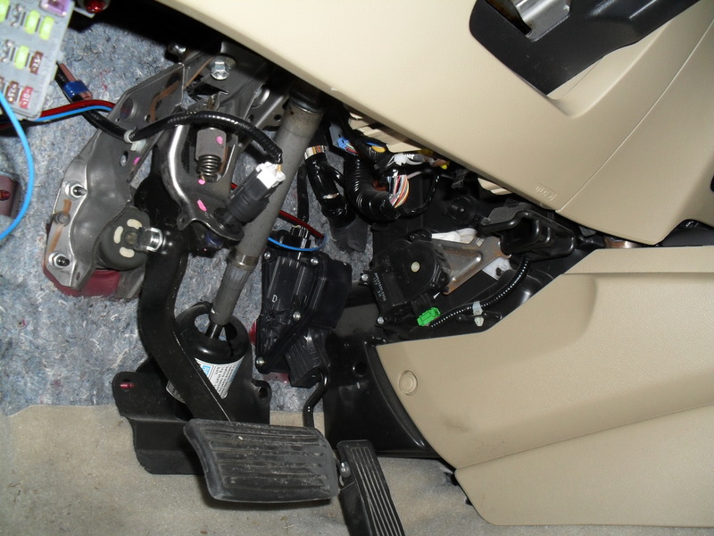

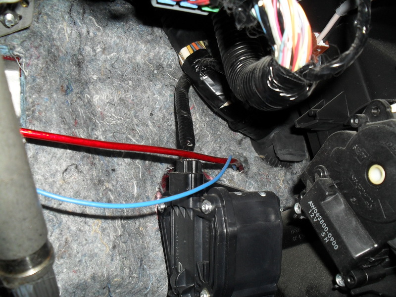

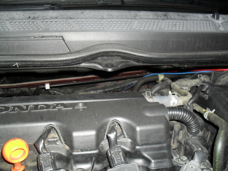

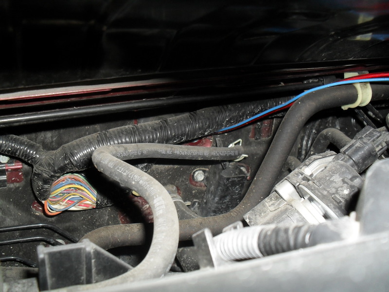

Re: 2009 Honda Civic EX Coupe Firewall
In my 2006 there was a hole only visible from the engine side.
Used a straightened out coat-hanger to punch through the carpet to see where it was on the inside.
The hole I found was a good fit for 4 gauge.
I dunno if you could fit 2 gauge in it or not, not sure what size wire you need.
I don't know how different then 2009 is, but here are the pictures from my 2006:
