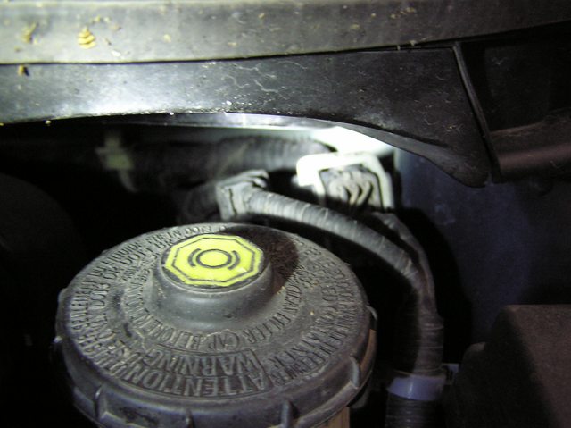

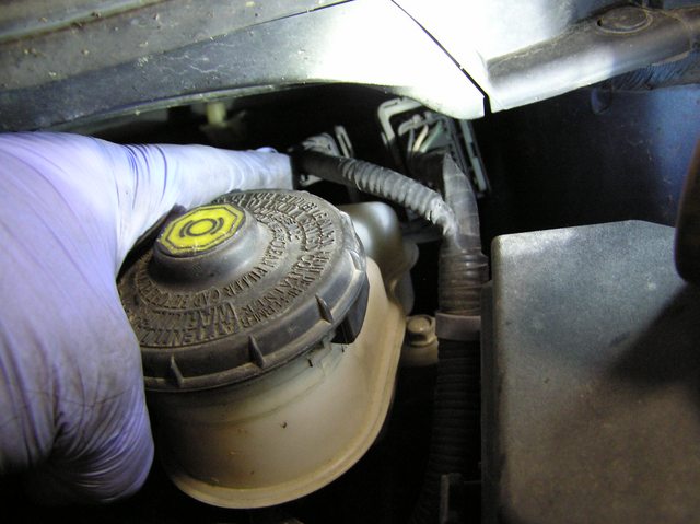

Here's pics of the small wire that leads to the starter solenoid
Size:  46.8 KBName:  Cr824SOl.jpg
Then wild stab at a bad starter?

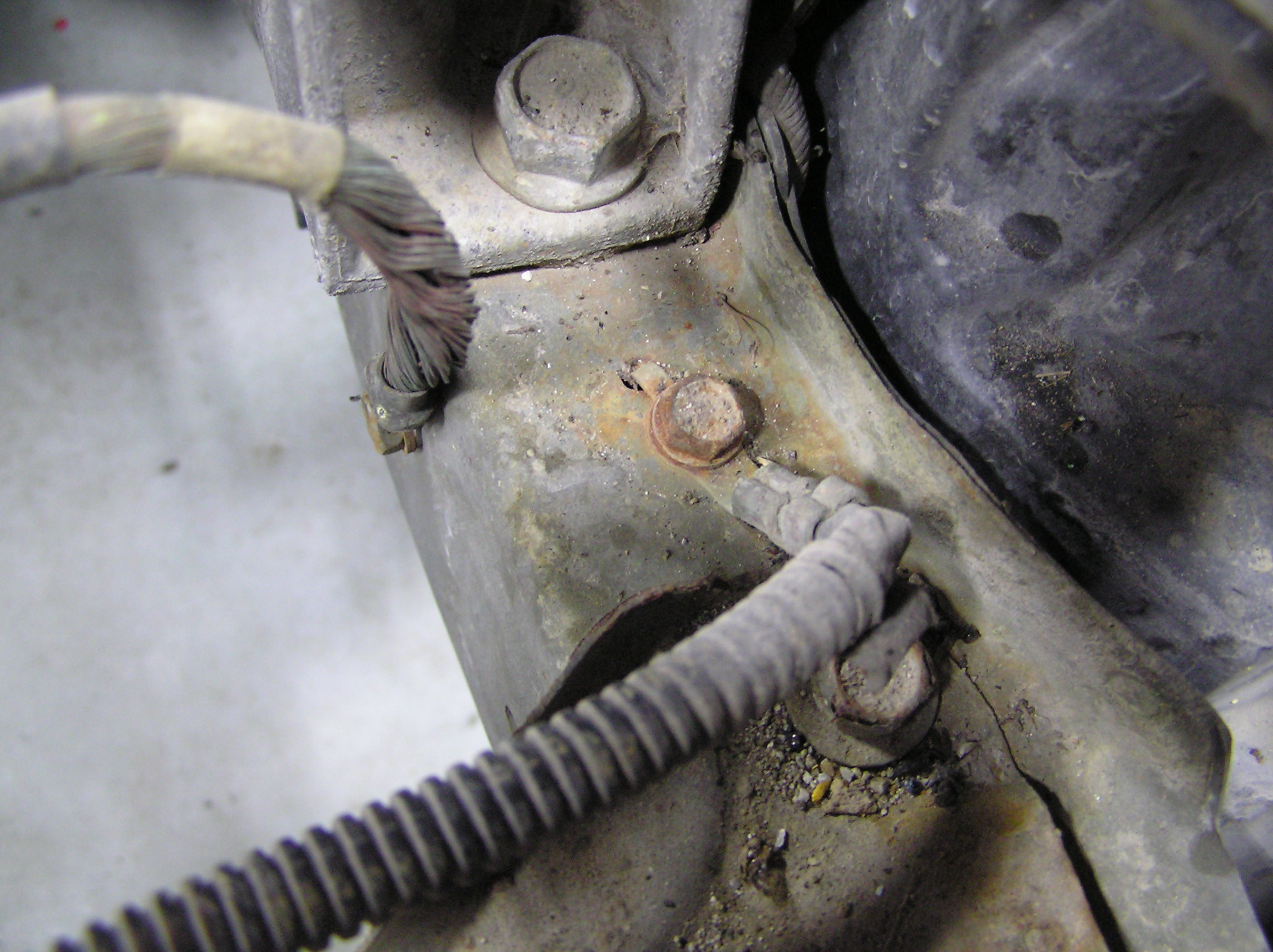

Follow the battery neg cable to the body, it's probably corroded and rusty. Look nearby, there is another ground cable bolted there that goes to the transmission. The other engine ground is attached near the mount on the passengers side.
Pic of those cables with battery and tray removed:
NOTE: I have seen this battery cable issue cause the entire car to go electrically dead when you attempted to crank the engine.
