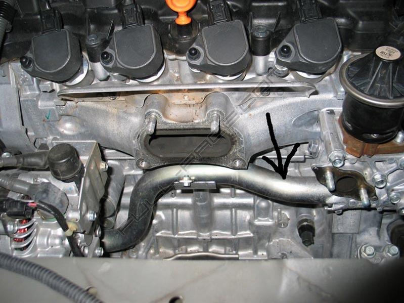

what is this pipe ??? plz tell me if yu know .... the one marked with arrow ......
That pipe has coolant in it. Carries coolant from the thermostat housing and radiator hoses to the water pump.
The thermostat housing also contains the EGR valve.
this noise is coming from the area where egr valve is located where this pipe is going through the egr section .. i think this noise i am hearing at oil presseure sender area is just the reflecting sound because of the plate which is directly below egr valve .. the noise is originating at egr section somewhere .. correct me if i am wrong .

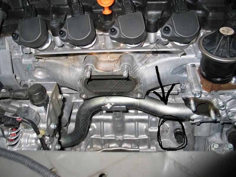

i am darn sure ,,, this is coming from this area only ,,, marked with circle in the image ,,,, i checked with the garden hose by listening to the sound ,, aalso checked egr thigs ,, its not from there ,,, its from the circled area ,,, help me jesus ,,,

Sir now please give me an advise for what to do next .
Old Jul 24, 2014
Re: this weird noise on my civic 2008 ex ,,, coming from near oil pressure sender ,,,
Is your noise something you can hear inside the cabin while driving?
Um.... Since I can't tell exactly what noise you are hearing and you seem to show a location that's not a common issue area on that engine (IMO).....I'll say to go to someone that has experience fixing problems.
Visit an authorized Honda dealer that employs techs that have lots of experience (meaning not the oil change rookies).
Demonstrate the noise for the tech.
Ask if this is a noise that should receive further attention --- or is the noise something that is of no dire concern.
While you are at the dealer, check out an identical car and see if it makes the noise too.
HTH
okk thnx,,i found smething very interesting here ,,,
almost same noise as mine ,,, this guy,s noise went away after oil change ,, and ya i m also running low on oil ,,,
next week get it done by HASS ,,, can low oil be the reason ??
coz there is no one that can tell me bout dis ,,
Old Jul 25, 2014
JUSt how low is the oil??
If it is only at the low mark on the dipstick, I wouldn't expect any unusual noise at all.
But if the oil is so low that it is no longer registering on the dipstick, then .....well.....you should have already added oil before it got that low.
I suppose all sorts of bad $$$$ noises can happen if the engine runs out of oil.
Take care of the oil and you should have your answer.
Let us know!

can a vacuum leak occur on oil pressure sender ?
here is a video ,, m afraid what it is ,, i m unable to diagnose it .. help me ,
any one plz help me with this noise ,, it is anoying me ,,,
according to my diagnosis its from near oil pressure sender unit ,,, help !!!!!

Replace the damn thing already.
It is oil pressure.... no vacuum involved.
I could likely come up with all kinds of noises using a plastic tube and probing around the bay..

then how to pin point the noise ???
its intensity is highest there at oil pressure switch ,,
