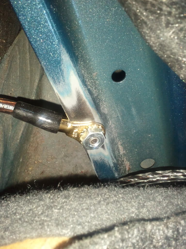

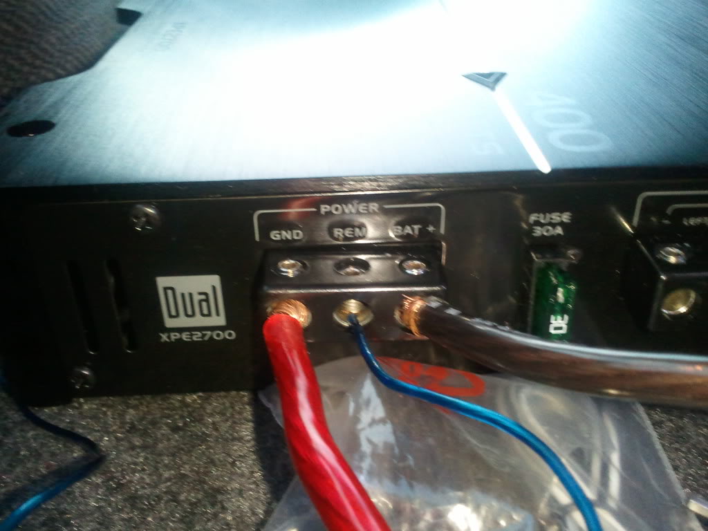

The Remote Wire To Fuse Was The Last Place I Tried Putting It.
And To *Jalldred I Did Try To Connect It To A Hot Wire Even To The Battery.
I've Tried 2 Different Amps And Still Nothing. They Both Work Fine In My Friend's Car. But Doesnt Seem To Want To Turn On In My Car...

You wired it backwards. The red wire should be in the Bat + and the brown wire in the Gnd.
Reverse the wires and it should work.
Oh, and the friends that checked the wiring, don't have them do any electrical work on you car

I hope your remote wire is not being held into the fuse panal because you jammed a fuse in there. That should really be soldered to the ignition wire or at least crimped. Your going to probably need a new 30amp fuse for your amp to since its probably blown.

Lol my bad
i actually had it hooked up right before.
i'm returning the amp back so i took it out and wired it real quick just to show you.
