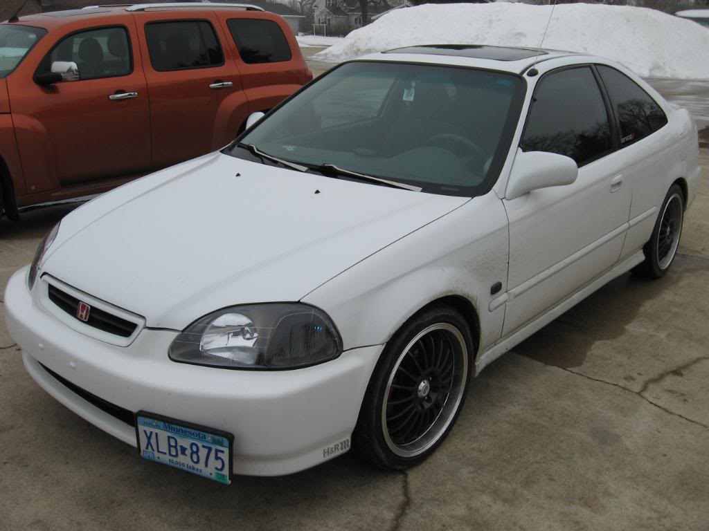

Here's my civic on 17's (whoring it up)
Really want some 15" Slipstreams though...

And I thought I had wheel gap
But he is right smaller wheels is alot more functional, where bigger wheels is all form... Function>Form!

Re: is 17" too big?
I think the gap looks fine if its even. Unlike when the suspension is lowered, you tend to still have a gap on the sides, so it's kind of bell shaped, which looks less balanced than a unifom semicircular space. So maybe you'd need ground effects to hug the tire on the sides, in order to complete the gapless look, or bigass fenders which bulge outwards over the tires. Or am I missing something?

Re: is 17" too big?
Werd, mine is lowered .75 which is just enough to get rid of the awkward gap from putting rims on. I definitly agree that some cars look weird lowered...
but its all in how you do it...
