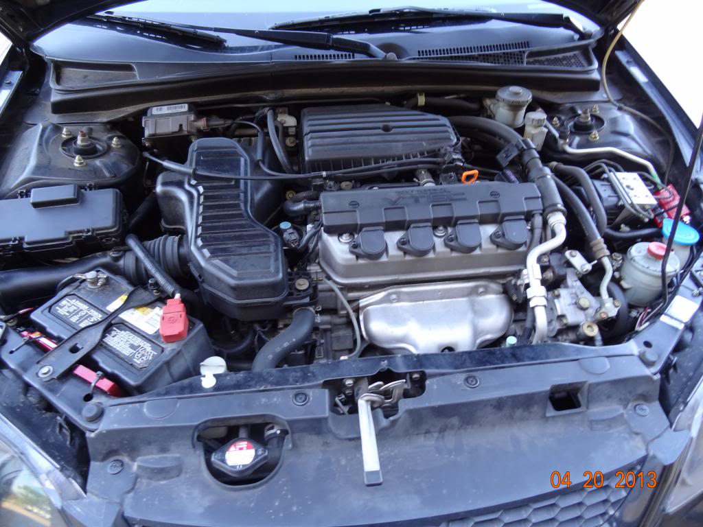

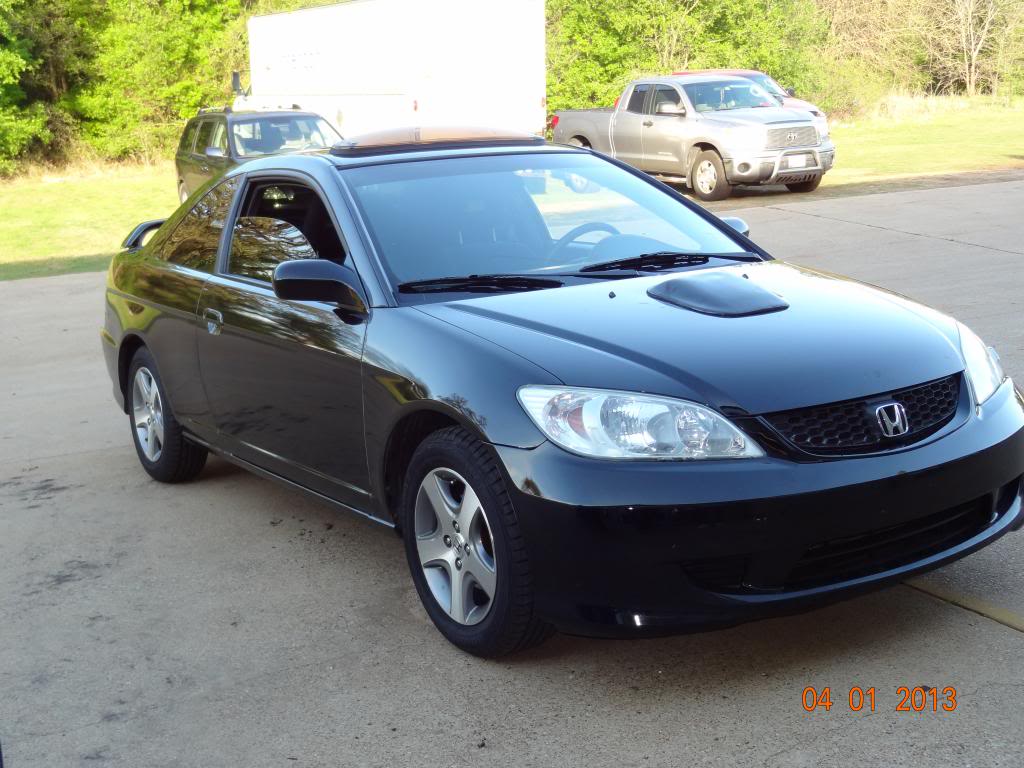

Purchased a Honda Civic coupe mid February, nothing special- a 5 speed w/ sun roof
The goal = 600 (reliable) HP (wife thinks I'm going through my 2nd childhood I told her I never left my first... besides I'm a gear head at heart)

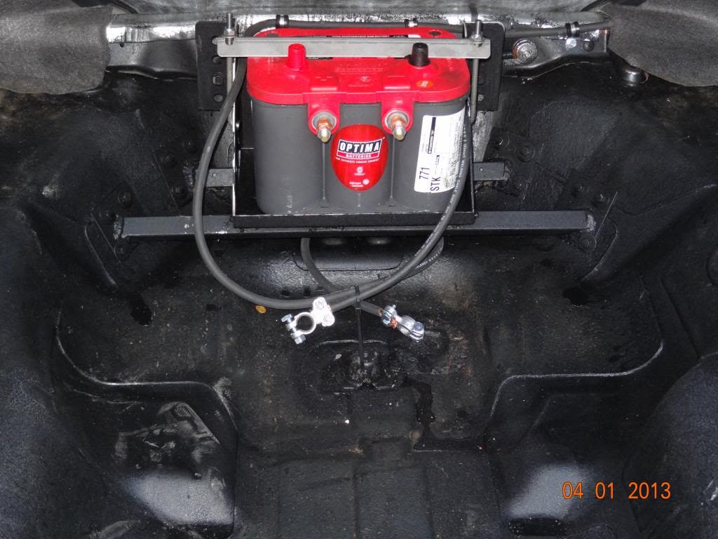

Moved the battery to the trunk (low and centered) had to fab up a mounting bracket for the battery
Upgraded to an optima battery

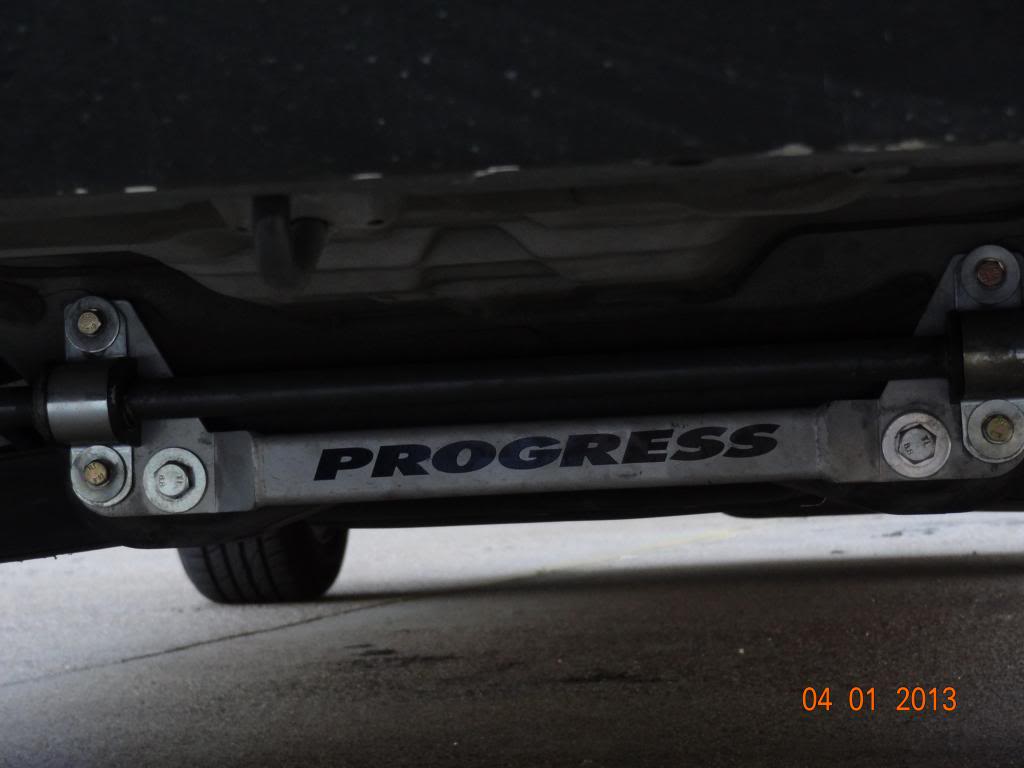

Upgraded the front and rear sway bars

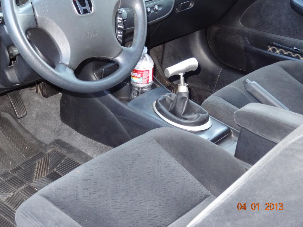

Installed a K-Tuned shifter (I love this shifter) also have the K-Tune shift cables
btw; if you plan to do a swap you don't need a different shifter the one you have (assuming you're starting out with a manual) will work just fine (one, of the many, misinformed bits of information i ran across)
But the difference between the K-Tuned shifter and the stock plastic one is night and day
Installed a Hurst shift handle (I'm old school)

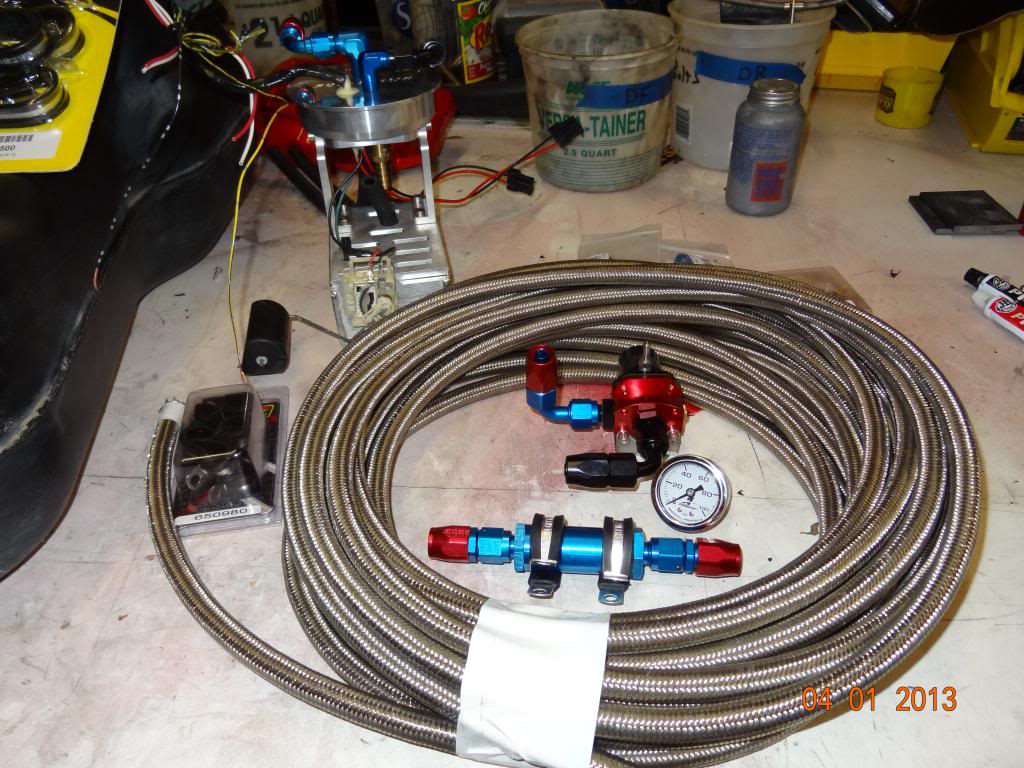

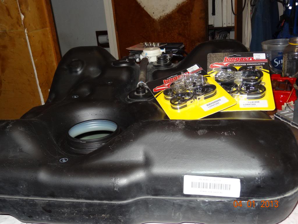

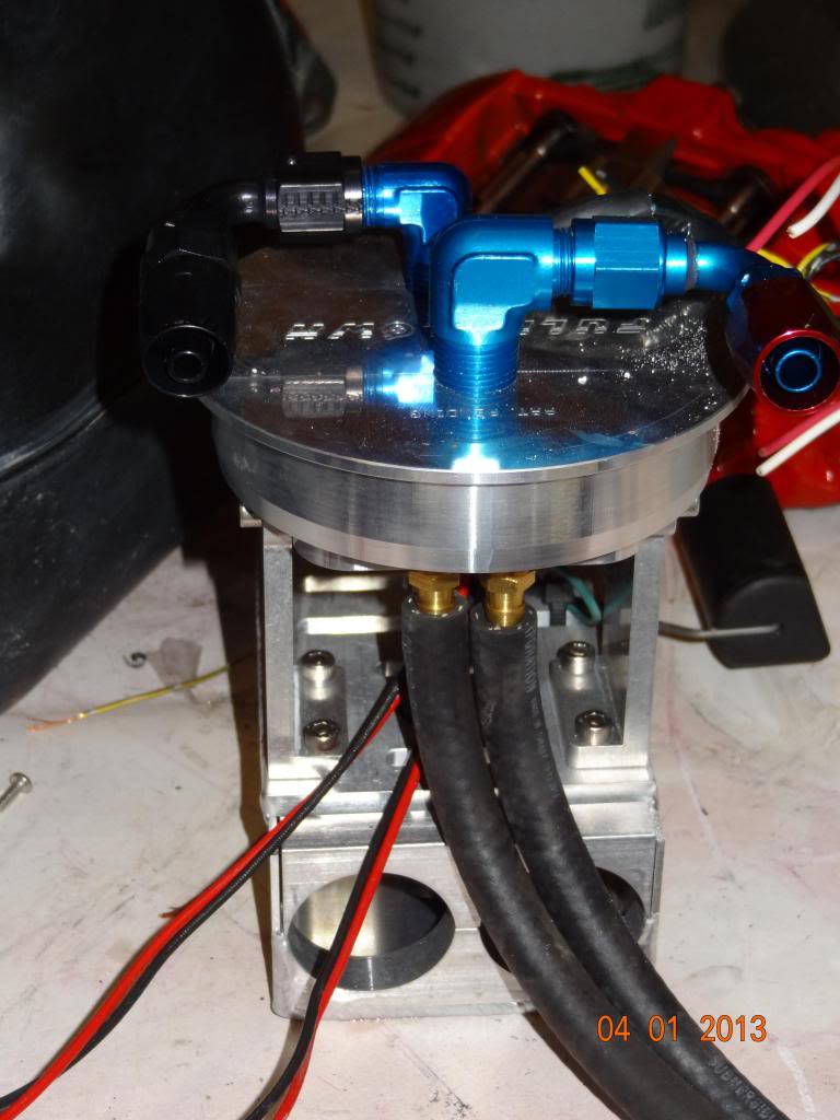

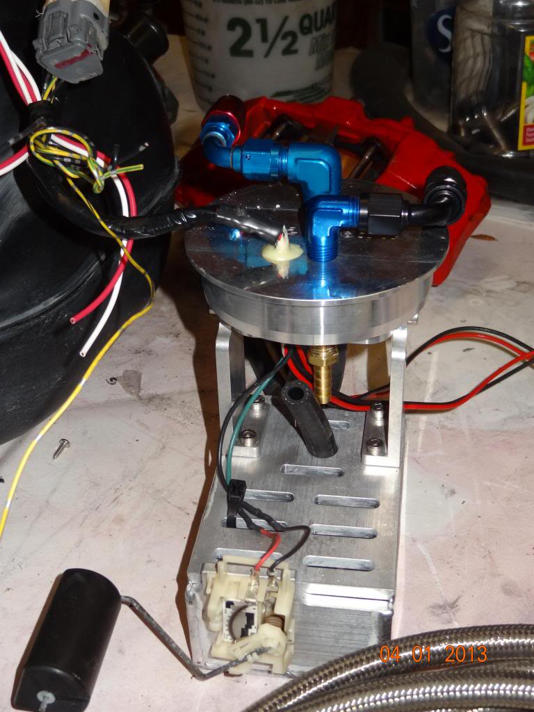

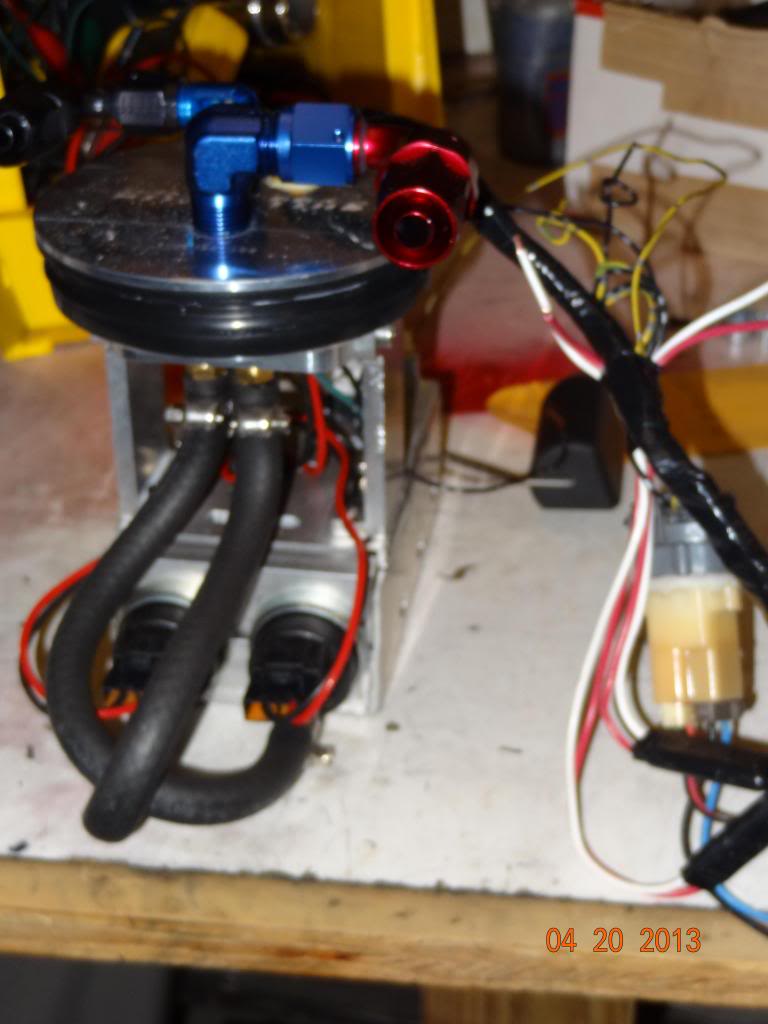

Fuel System; pulled the fuel tank from the donor car/ purchased a dual fuel pump hanger / and plumbing the 04 Honda w/ -6an SS feed and return lines.., full flow fuel filter/ regulator
Wiring up a dual relay harness to power the dual fuel pumps..., good news is, the stock fuel gauge sending unit bolts right up to the aftermarket hanger
The plan will be to drop the existing tank, bolt the modified one in then plug N play with the stock harness (the wires currently powering the existing fuel pump will power the relays feeding the aftermarket pumps)

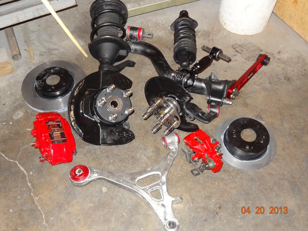

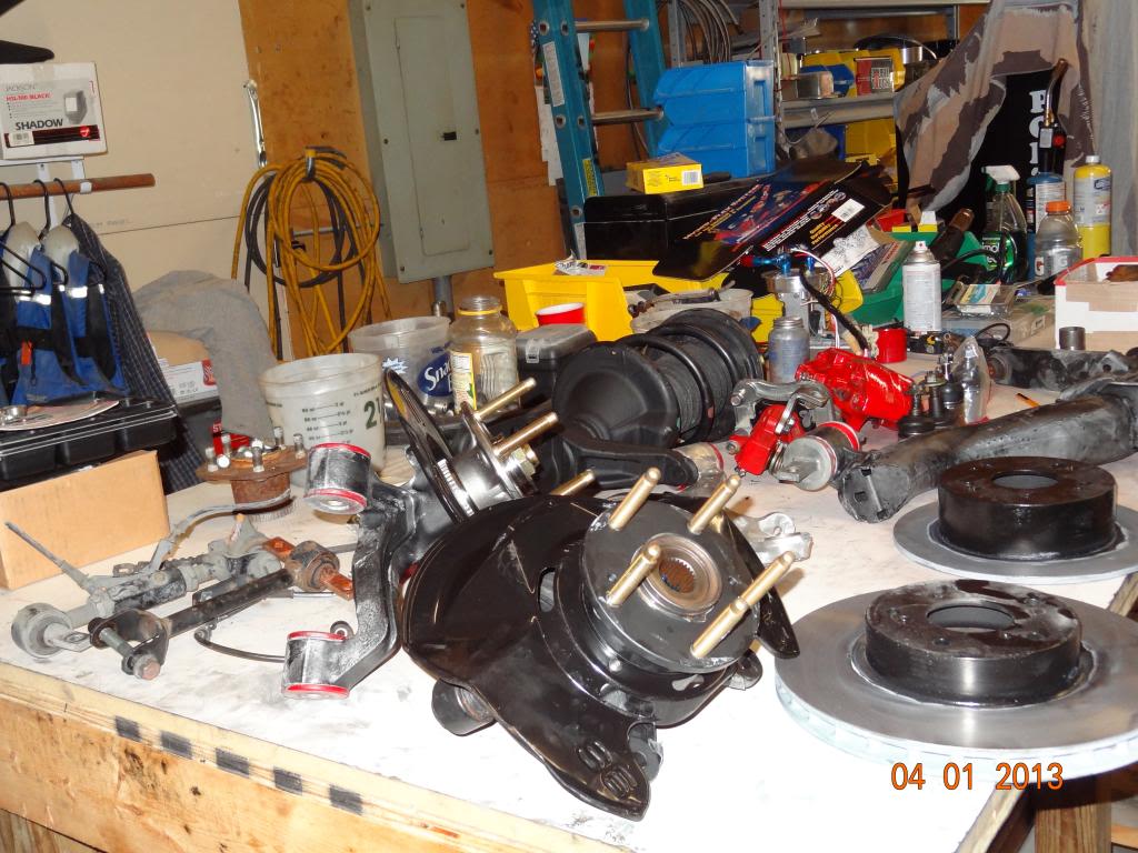

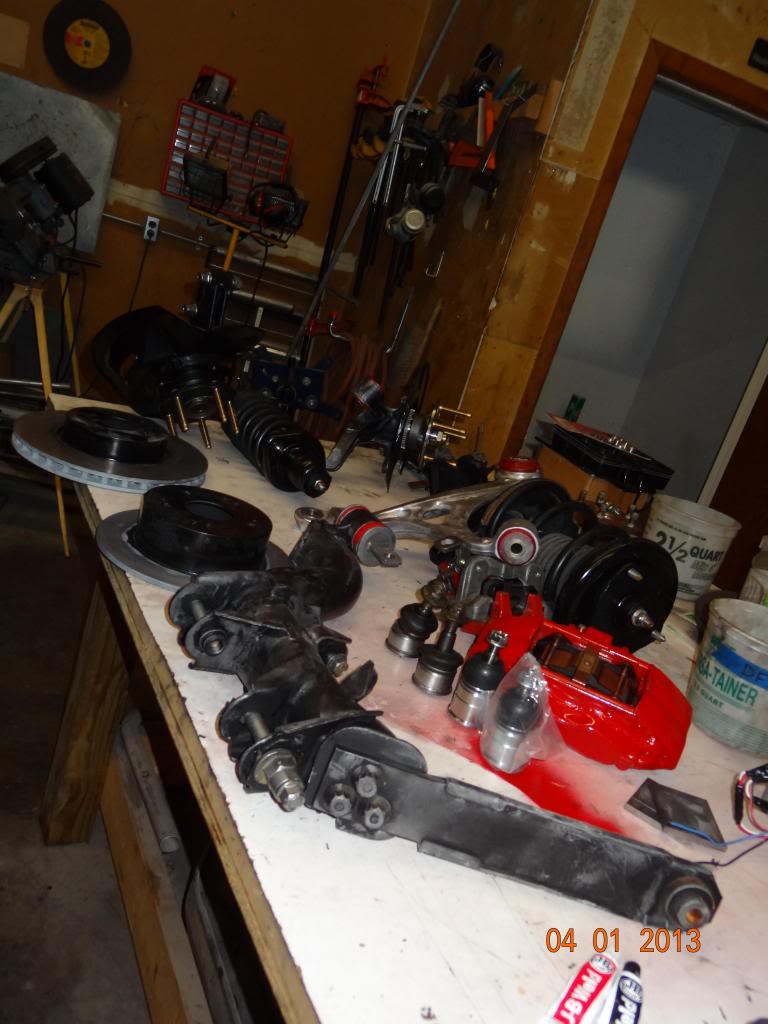

The DC 5 suspension
Came complete except for E Brake cables and Brake hoses
So far

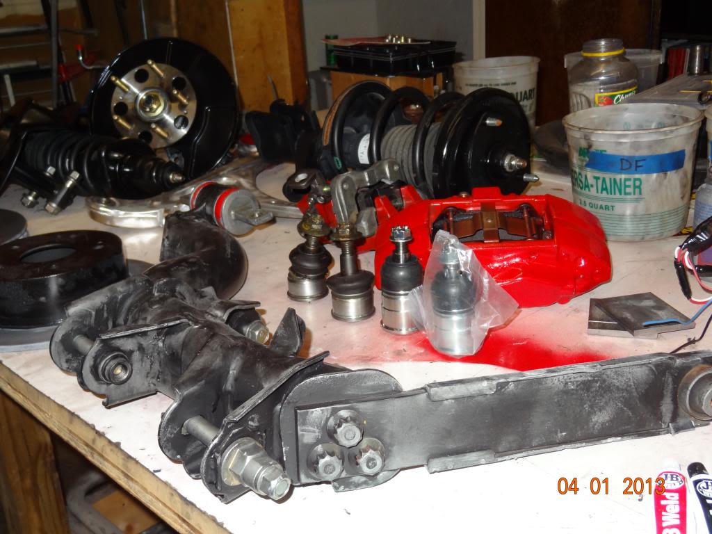

Completely disassembled, cleaned, and painted it
Replaced all bushing w/ energy suspension (when removing the bushings I found that burning them out w/ an acetylene torch worked best even better than a press) yup used anti-seize on the new bushings
New Brake pads (btw the fronts take one kind, the rears a different)
Resurfaced the rotors (I got lucky and had more than enough material to do so)

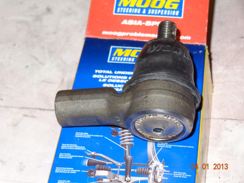

Replaced the ball joints (they are bigger than the stock ones yeah I bought the wrong one initially)

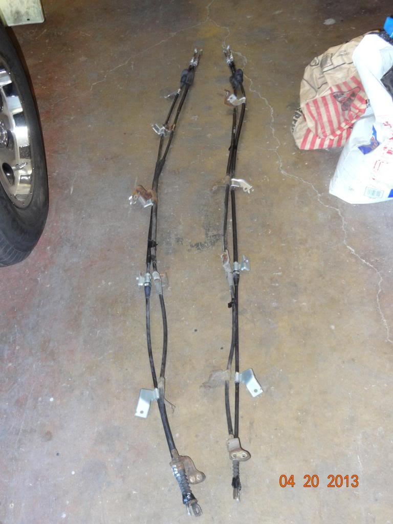

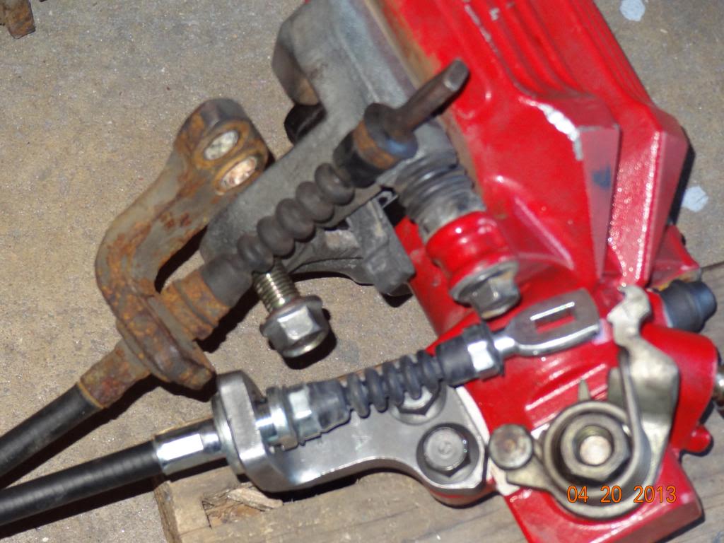

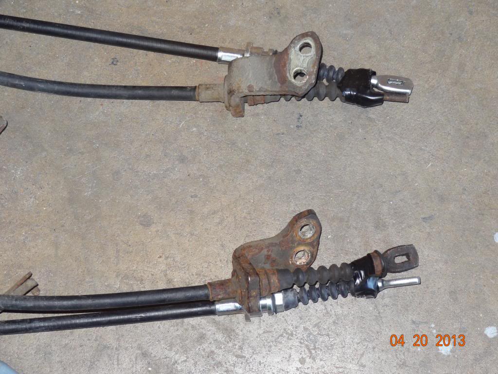

Purchased some Ebrake cables and SS bake cables (the brake cables are tricky to find)
Refurbished the calipers (brembos)
New front bearings
New rear hubs
New longer ARP wheel studs all around

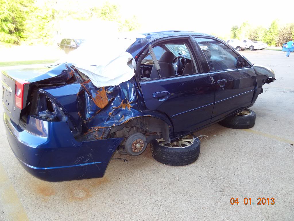

Donor car

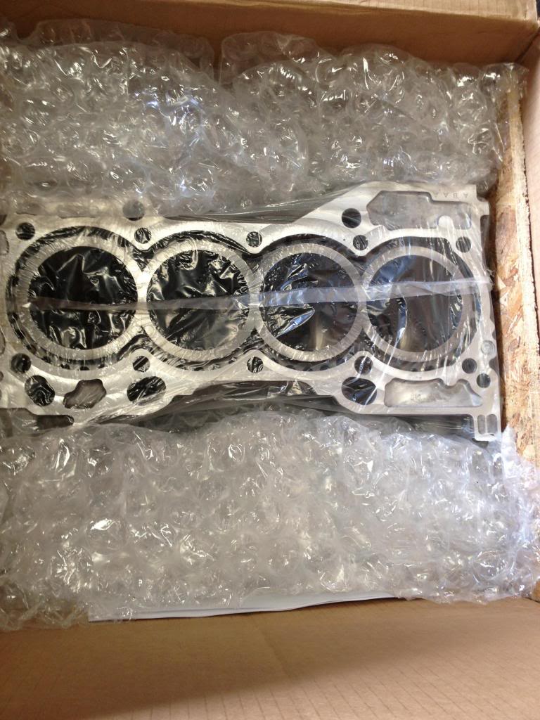

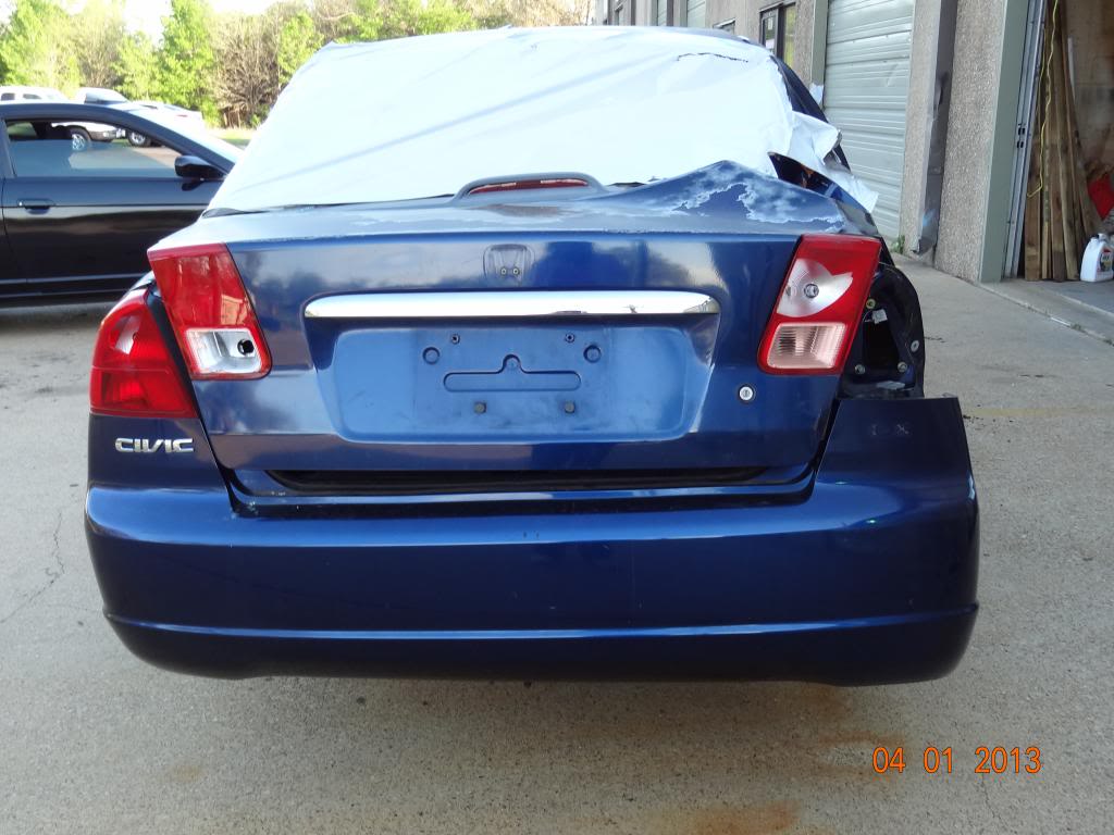

Originally was a 01 Civic, 4 door automatic that the PO had converted to manual, added a K20/ 6 speed/ sub frame/ honddata ECU/ hasport mounts
Unfortunately he rolled it and totaled the car then sold it to me

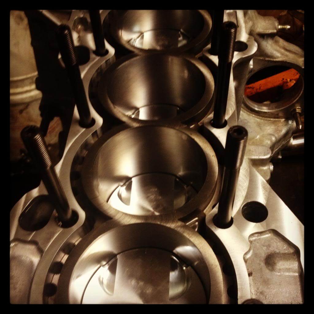

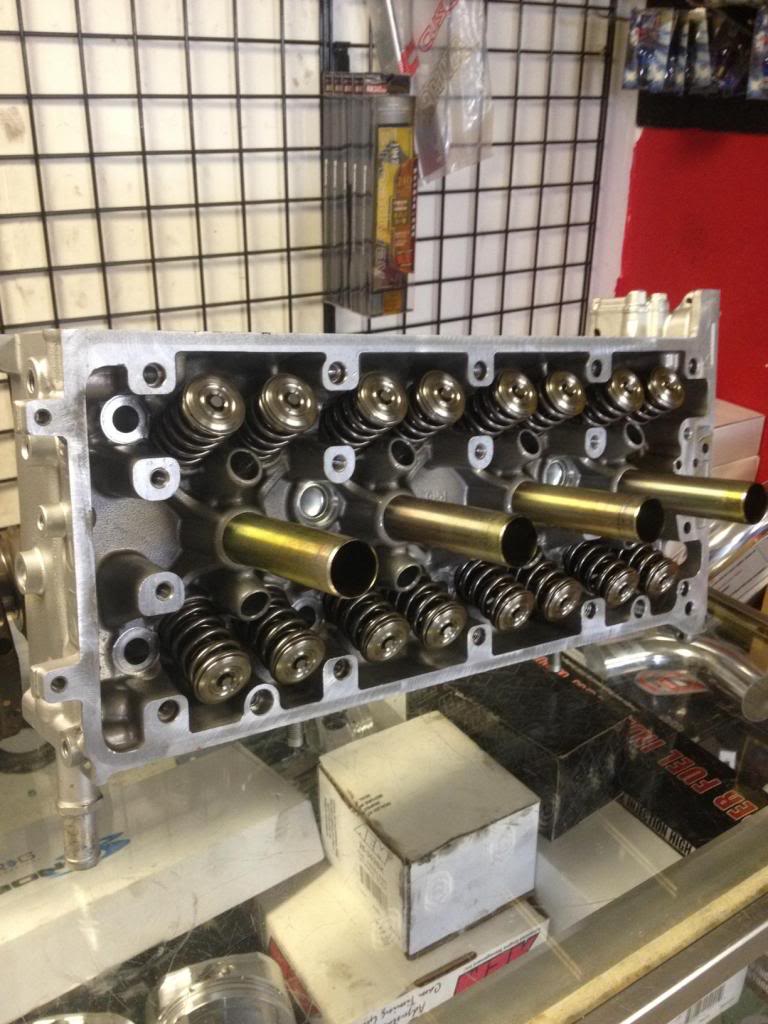

I yanked the motor/ trans/ subframe (btw for a Kswap you'll need the proper subframe) and hauled them off to the engine builder

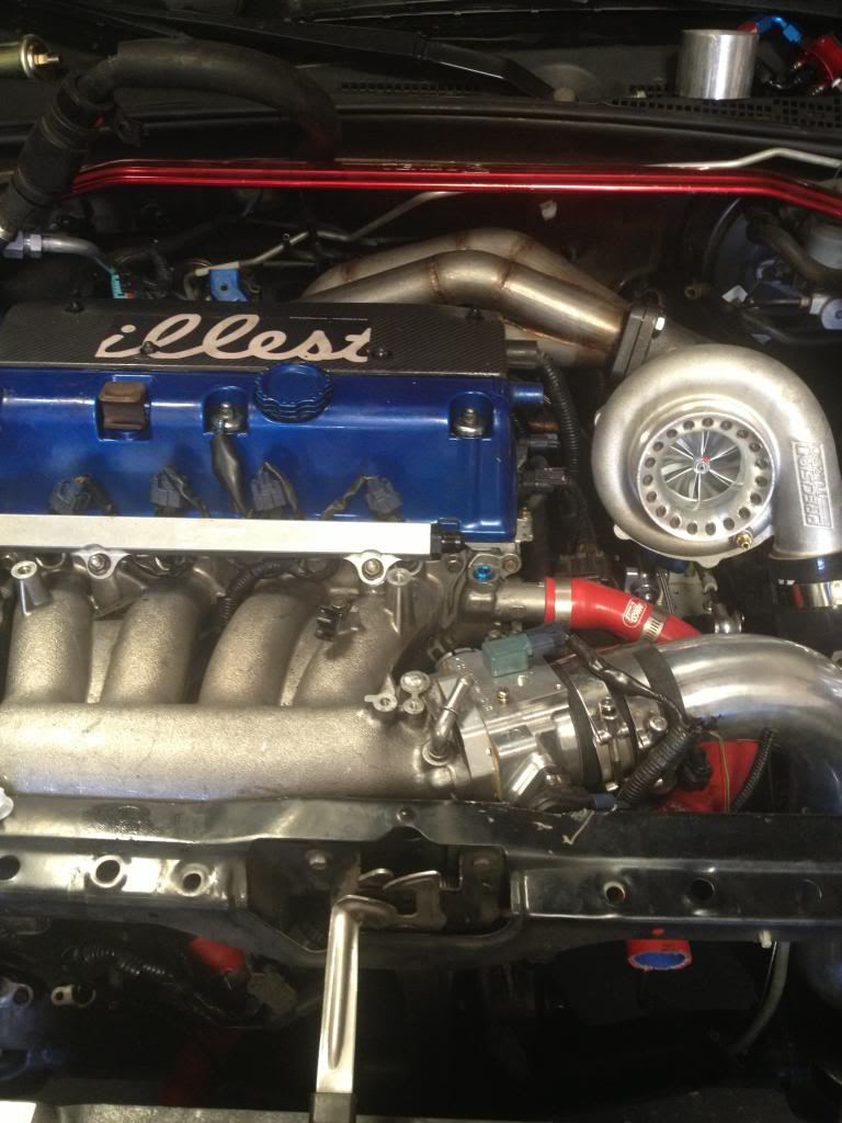

The builder is sleeving it/ adding a girdle/ bigger rods/ port/polishing basically making it bullet proof block to head
Once installed he%u2019ll add a turbo and inter cooler
Head is finished/ block is still being machined

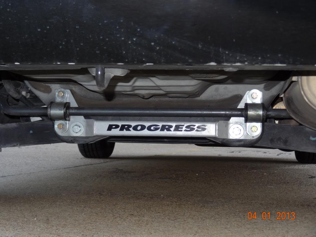

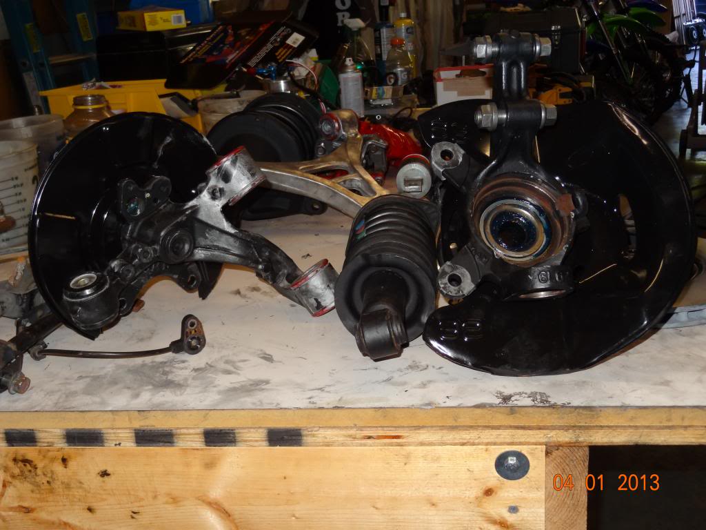

The DC 5 suspension
So far

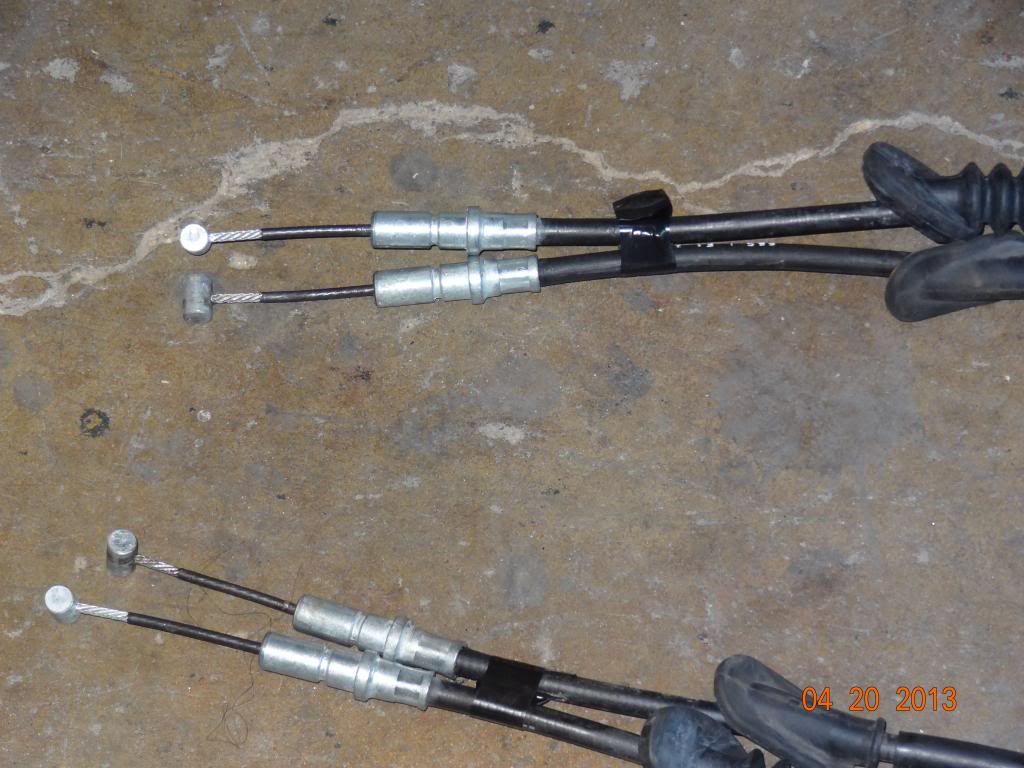

New front bearings
New rear hubs
Suspension upgrades remaining;
Waiting on the rear upper (adjustable), and rear lower control arms they've been on back order for over two weeks
Need to find 5 lug wheels with the proper offset (what I want may not work)
Wider tires and probably 16 inch
Will I eventually lower this car only if I think it'll improve handling otherwise I couldn't care less

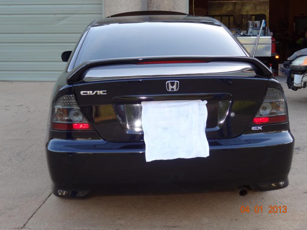

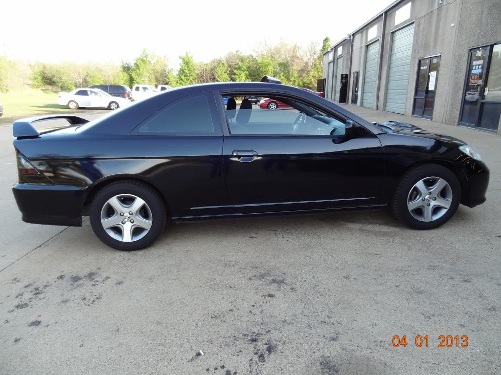

Re: A Little Project
Car upgrades remaining;
Adding a hood scoop (not for additional air in, but to exhaust hot air out of the engine bay) have the scoop, just need to cut a hole in the hood and mount it (heat kills motors and HP)
Adding HID halo headlights (This one is being a real PITA)

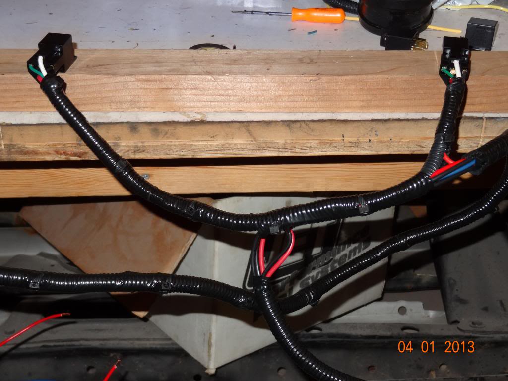

Added;
Rained last night – first time since buying the car – trunk leaks – needs fixed
Windshield cracked from P side to D side along the bottom – may or may not replace it

Donor car;
Received the title in the mail today, now it can be hauled off to the junkyard

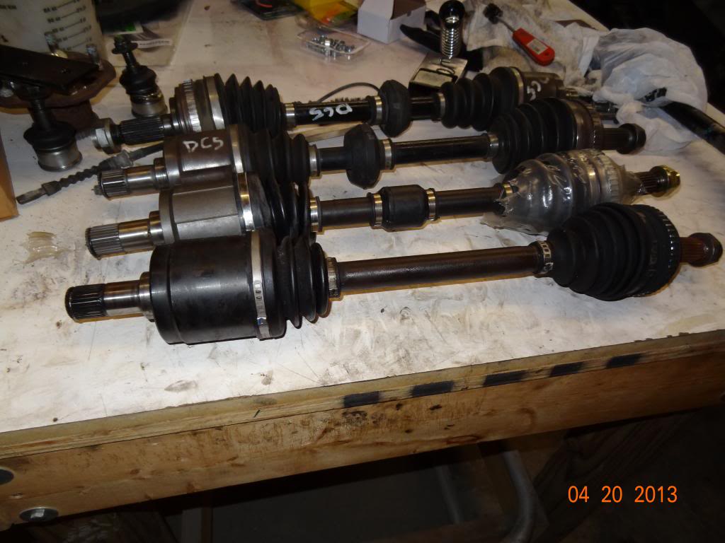

Added

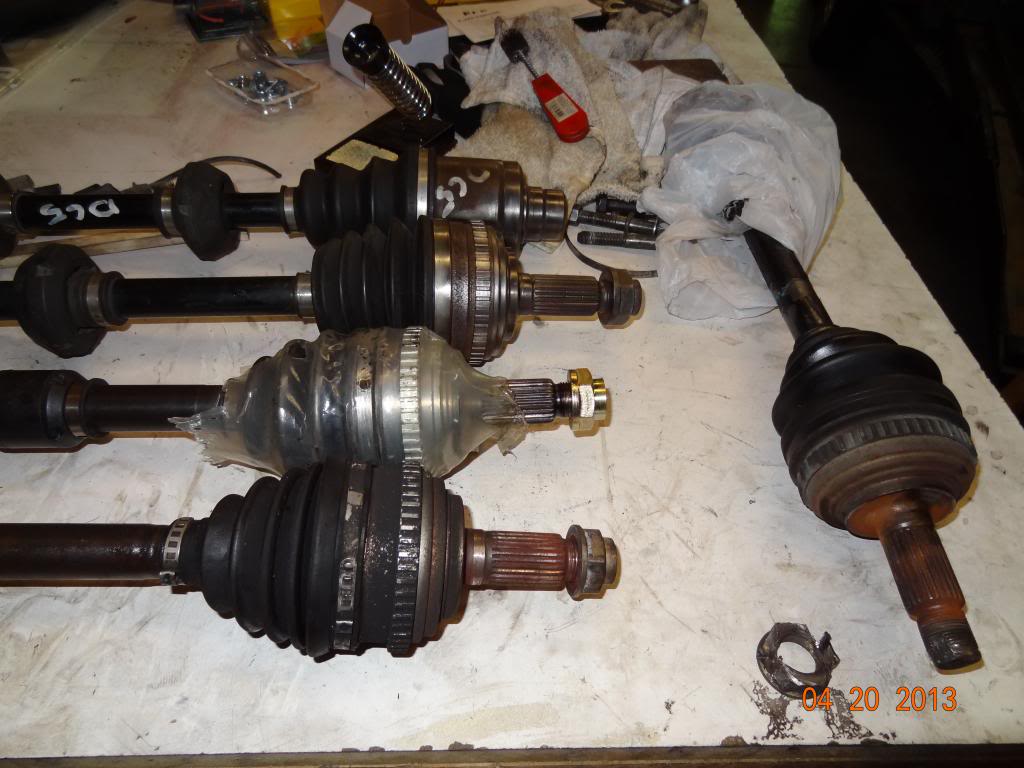

SI axels

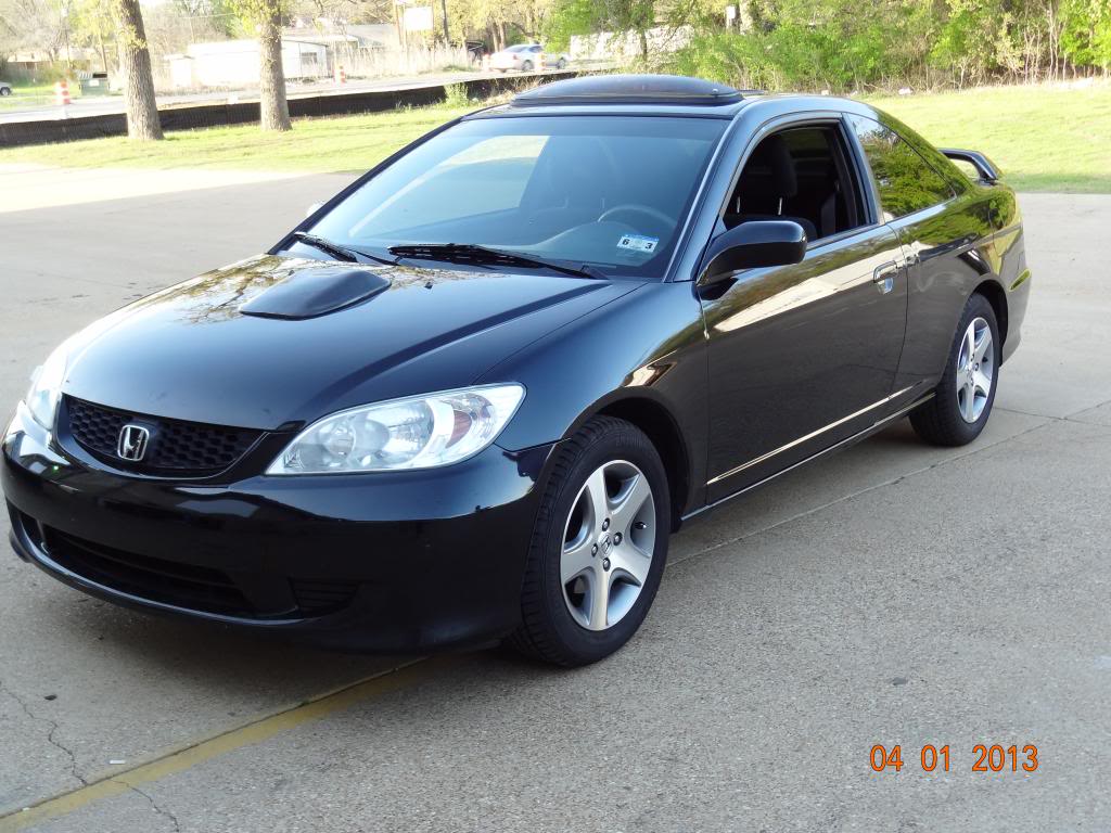

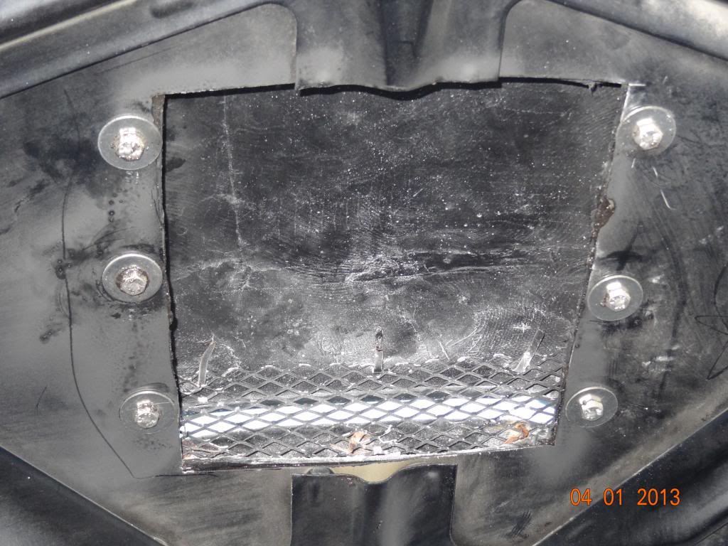

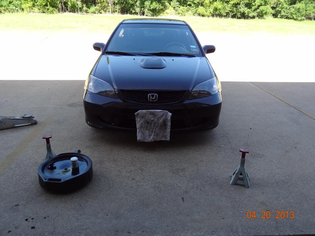

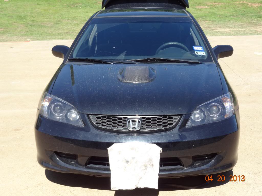

Hood scoop
Made a template from cardboard, positioned on the hood – and was about to cut a hole – then thought better of it
Didn’t have the mounting hardware (nuts/ bolts/ washers)… and wanted to install a rubber gasket – which upon thinking about it – believe I’ll just run a wide bead of black 5200, and not fab a rubber gasket
Now I have the hdrw, and plan for a gasket – tomorrow the hole gets cut

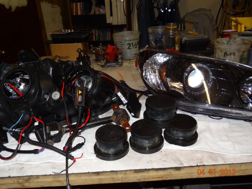

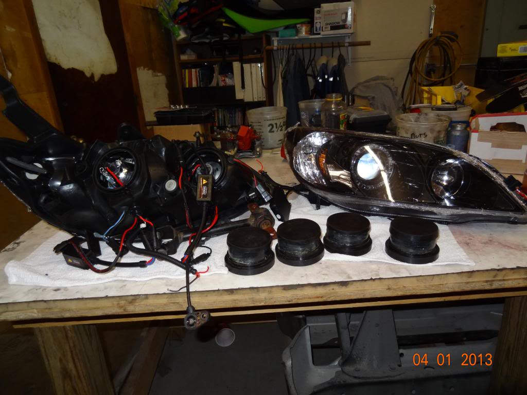

Back to those PITA halo lights

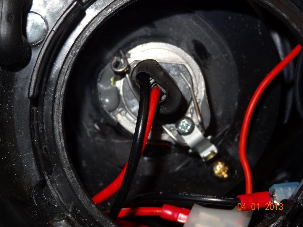

So I purchased, what I “thought” – was a pair of quality HID Halo headlights –from a reputable supplier – boy was I ever wrong
Out of the package
Neither light worked (connected directly to a known charged battery)
The rubber cups (weatherproofing the bulbs) over the halos – fit like crap (the cups are too short for what they’re trying to cover and don’t fit at all)
When I went to remove one of the bulbs on the driver’s side H3 – the screws holding the retainer clip fell out (they were stripped) and the pot metal (comprising the area around the where the bulb fits into the reflector) was cracked
Contacted the supplier – may as well been talking to the wall – they’re maintaining I don’t know what the hell I’m doing – yeah okay…
I also attempted to find a replacement reflector – that ain’t happening so;
Today I tore into them, this is what I found/ came up with
Wiring was bassackwards – positive output of the ballasts were connected to the negative side of the bulb.., and vise versa – on every bulb…
Also a few of the spade lugs were poorly crimped (loose)
Fixed the wiring – all four lights work
As for the stripped out screws/ busted up reflector base – used some masking tape to make a form around where the hold down screws (on the reflector base) – screw in…
Mixed up some JB weld…, built up the area.., inserted the screws
Tomorrow I’ll know if it worked – initial indication is looking pretty damn good
The rubber cups over the halos; If they were only 1/2 to 3/4 of an inch longer – they would fit perfect

SI axels
Out of the package
Looked on line for replacements – that ain’t happening – so time to improvise….
These boots are about 3 inched in diameter… hhhmmm they make rubber, pipe end covers, for 3 inch pipe…
Went to Lowe’s and found one – it would work… but they only had one – crap
Looked around some more and stumbled across a rubber 4 inch to 3 inch downspout connector.
The 3 inch end looks to be about a 1 1/2 inches long
Bought four, took them home… cut the 3 inch section off..., split the cup (cut the bottom off about 1 /4 of an inch above the end..., then inserting the 11/2 inch long 3 inch section between the cup ends – thus elongating the overall cup length by 3 / 4 on an inch
Used contact cement to glue in the mid section
So far – appears it's going to work (glue need to dry completely)
Lights should be installed tomorrow
And why contact cement instead of rubber glue – its all Lowe’s carried – it should work, and remain pliable – we shall see

The suspension also came with the wishbones – hopin they will bolt right up – fingers crossed – we’ll see once I get the RCAs
Today;
Scoop
There is a nice new hole in the hood, covered with a scoop – sweet (I’ll do a small dyi in later in this post)
Lights
Lengthened cups – worked
Jb weld – worked, bulb is installed and solid
Didn’t install them today though, but I did plug them into the car’s harness – they work
I wanted to let the contact glue dry/ set a bit more, also have some new front bumper clips arriving tomorrow – so later in the week they should be done

Donor car;
Any other parts I need off it – nope – time to get it gone
Okay the hood scoop dyi
Disclaimer;
Not saying this is the only, or best way – simply offering it up as assistance
Tools
Safety glasses
Gloves
SS – Bolts/ fender washers/ self locking nuts
Jig saw w/ metal cutting blade
Drill
3 drill bits – one for the jig saw pilot holes/ one for the mounting bolts pilot hole/ the last one big enough for the mounting bolts
Masking tape (I prefer the blue kind)
Large towel (preferably one from a hotel you um “borrowed” many/ many years ago )
Cardboard template of the scoop – with the center cut out the same size as the scoop’s hole – and it should be an inch or two bigger than the scoop
Silicone calk
Calk gun
Plastic putty knife
Dremel w/ carbide bit
Couple of short 2x4s
And of course the Scoop
Put on the safety glasses and gloves
Mask a centerline down the hood
Mask the scoop to the cardboard template
Place both on hood and position
Mask (mark) the front and back edges of the scoop, onto the hood, where you want the scoop to sit on the hood
Measure/ look/ measure/ look/ measure/ look/ measure/ look/ measure/ look/ measure/ look/ measure/ look/ measure/ look/ measure/ look –from all angles – twice/ thrice/ how ever many times it takes to suit you/ get it right
Make sure you like where it is sitting
Let’s face it – easy to get impatient with this step – but if you screw up the placement – you’ll be staring, and reminded, till the day you sell the car
So take your time, and get it right, life will be good
Tape the template to the hood
Remove the scoop from the template – leaving the template taped to the hood
Again – verify you like the placement
Open the hood and place the towel over the engine, directly beneath where you’ll be cutting (to catch the metal filings)
Place the 2X4s on their edge, under the front of the hood – this’ll raise the hood up far enough so you not sawing into the engine
Lower hood down onto the 2X4s edges
Drill a pilot hole near the corners of the template – where scoop hole is to be
Hope to hell you like the scoop placement because now you are committed
Cut out the scoop hole
Btw the cardboard will also give you a surface to run the jig saw over – thus NOT scratching your paint
Note – you will be cutting into the center brace of the hood – don’t worry about it – the hood is still solid and rigid after that section of brace is removed
Remove the towel, shake it out, and replace
Remove the template
Place the scoop on the hood and align it to the hole
Tape scoop in place
Drill one mounting bolt hole – in one of the corners of the scoop’s mating surface – through the hood, and through the scoop’s mounting surface
Caution – use the pilot drill bit first, then use the full size bit – and go at a slow drill speed as the bit is breaking through the metal, and starting to touch the carbon fiber…
Carbon fiber is easy to drill through, bit it also likes to grab the drill bit and then nasty things can happen
Drill slow
Next, drill the full size bolt hole
Install the bolt, two fender washers, and the self locking nut
Tighten slowly till snug – and only snug
You can then swivel the scoop for a perfect fit
Drill remaining holes and install the bolts/ washers/ nuts
Caution;
Always tighten the bolts slowly and equally so no undo stress is placed on the carbon fiber
Should the hood hole and scoop hole not match – either cut a bit more off the hood’s hole, with the jig saw…, or use the dremel and carbide bit to widen the scoop’s hole
May as well get em matched perfectly
Now close the hood and admire your work – for a minute or two – as there is still work to do
Next
Tape completely around, and butt up next to – the edge of the scoop – including the corners
Remove the scoop from the hood (yeah unbolt it)
Paint the edge of the hole you just cut in the hood, and the holes you drilled into the hood for the mounting bolts (protect from rust)
On the scoop, run a goodly amount of silicone completely around the lip of the scoop (mating surface with the hood), flatten and even out with the plastic putty knife
Reinstall the scoop
Slowly and equally tighten all the bolts
The tape you put around the scoop will keep the silicone off your paint, should you slip while reinstalling… and it’ll also catch whatever silicone oozes out as you’re tightening the bolts down
Remove the tape – you’re done (oh and don’t forget to remove the towel and 2X4 – else more of those nasty things could happen)
However if you’re like me – you’ll drop a nut/ washer down into the scoop – usually the last nut/ washer you’re installing – which with then require the removing of said scoop completely to get the damn thing out
Although this last step is optional…, doing it 4 or 5 times typically leads to a few choice words, and frustration – what the hell…, may as well join in the fun – SO JUST DO IT and enjoy

Today;
Scoop

Donor car;
Disclaimer;
Tools
Safety glasses
Gloves
Drill
Silicone calk
Calk gun
Plastic putty knife
Remove the template
Tape scoop in place
Drill slow
Caution;
Next
Reinstall the scoop

That is an important bit of information (that I need the JDM K20 Type “R” axles)

Ebrake cables;
Crap, I need to check, but I’m almost certain I got the RSX ebake cables
If so, I’ll order the EP3’s
Please gimme me a day or two to take some… then I’ll bore y’all to death w/ pics

RSX cables WILL work. But they won't be perfect, to say the least
I'm still running RSX cables until I can snag some EP3 ones up cheap.

Let's see if this works
Notes
suspension;
What appears to be rust on the hub - isn't
The grey color on all over the suspension is anti seize - stuff gets everywhere
Tie rod ends are the bigger ones required for the DC5
Hope I didn't over do the pics
Ghost

Fuel System – complete wiring harness / install

Donor car – gone (wrecker driver like to talk... and talk… and talk)
Ordered – JDM DC5 axles / EP3 Ebrake cables

Removed the sun roof deflector – between it/ the wing/ and scoop – there was too much going on for my liking
Headlights installed – need adjusting (I like em)

Fuel System – complete wiring harness / install in second fuel tank

Install Fuel lines in/ under the car
Install pump hanger into spare fuel tank (harness is complete and verified)

Have all parts - need to assemble, then install onto car

Fuel system;
Motor guy looked at everything I pieced together, and mostly liked it... the only change need to upgrade the feed line, from the pump to the rail, to -8AN (instead of the -6AN)
Parts on order (hose, connectors, fuel filter)
Axles
DC5 = 28 spline into hub
SI/ Stock = 26 spline into hub
DC5 = ~ 5MM bigger round, than SI (end that fits into hub)... also DC5 is ~ 2 inches longer overall (I first incorrectly stated it was ~1 inch longer)
The ends that fit into the trans are identical (as one would suspect)

Suspension
All but done, waiting on the ebrake cables and tires / wheels

Suspension

Howdy All
Few things to cover this evening
Allow me to state/ restate the project
Take a 2004 Honda Civic Coupe; swap in a K20A motor..., and a complete JDM DC5 ITR suspension
I restate this so I'm clear..., and we all can keep this project separate from EP3 swaps - of any kind
Axles
As you view the pics
Bottom is the donor driver side
Next up is one of the SI axles I purchased for the K20 swap - with the stock suspension set up
Upper two are the DC5 axles specifically needed for the DC5 complete suspension swap
DC5 axles are longer..., bigger round at the hub end..., have 28 splines...., in stead of stock 26 at the hub end..., and the hub nut is 36MM - compared to the stock 32MM hub nut

Ebrake cables
I have/ had a set of RSX cables (Dorman p/n C660730..., and C660833)
It was suggested I needed a set of EP3 cables
Following pics compare the two (I taped each side of the DC5 to its EP3 counterpart)
Length = exactly the same
Brackets = the same, with the following exceptions;
RSX has one extra bracket, on one cable, near the hand brake end - that can be easily removed
So essentially - they are the same

The new headlights
The finished fuel pump
One side of the suspension (personally I think its sexy, not as sexy as my wife mind you..., but gettin close)
This pic is for posterity (the before)
I'll take another once the motor swap is complete

Axles
Next
Ebrake cables
Trunk leak
Think I fixed it this time
It was a combination of;
Old gasket not properly sealing
Years of dirt accumulating under old gasket
A gap, at the very rear, where the inner and outer sheet metal connected
Cleaned the dirt..., filled the gap with silicone..., replaced the gasket
Ran water over the trunk - dry as a bone
Waiting till the next good rain before I stick a fork in it (and call it done)

The new headlights

I thought, based on an update – the block would have arrived back a week or two ago – it arrived today (pic of it, and the head enclosed below)
So now the block is off to a local machine shop to get bored and honed – then back for assembly
Head is done
I’m thinking in ~ 3 weeks the motor will get installed

Anyway, here’s the block and head
Head is done
