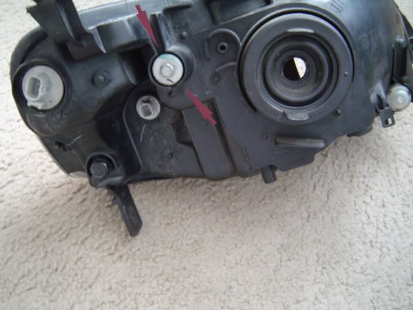

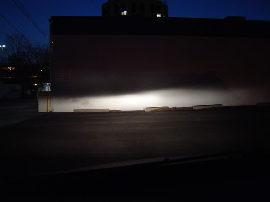

look for a gear in the back of the light that you can get to with a philips/star screwdriver from the top. this is an 01-03 headlamp but you are looking for something similar. then you park 25 ft from a white wall and do one side at a time so they are level and aimed properly (law says the left side of each headlight beam should have a 2 inch drop). meaning, when you measure the distance from the ground to the center of the headlamp, then go to the wall and measure the same distance up, the left headlight beam should be two inches lower than what you measured. basically so the headlight beam has a downward slope. if they are straight parallel, you will blind everyone. you have to experiment with the gear and see which way turns it up or down.
sample aiming
