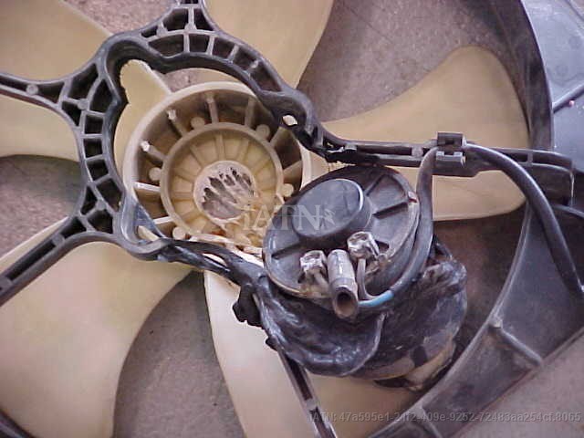

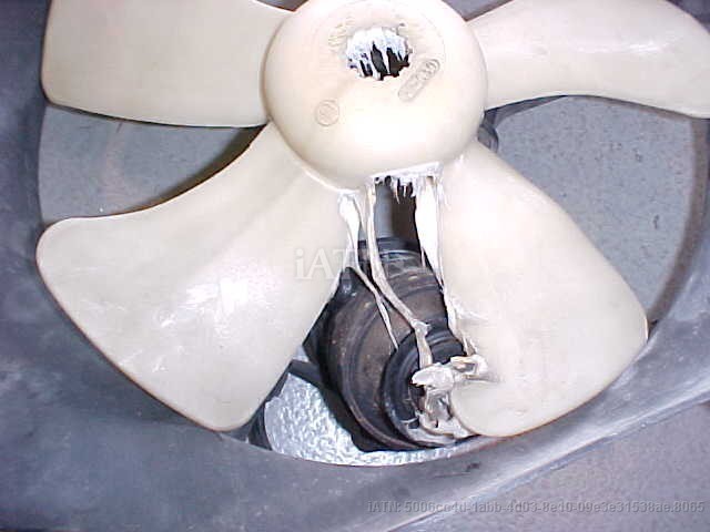

Assuming it blows the #56 fuse and the AC system quits because of that:
I'd fully expect the condensor fan motor to be bad and blowing fuse before the clutch, unless there's bare wires shorting somewhere..
Can you test each unit with an ammeter?
If you can't test each item with a real ammeter to find current draws, I'd probably unplug the compressor connector, then turn on the AC system and make sure the condenser fan still runs.
Then drive around with the condenser fan running for a while, see if the fuse blows while running just the fan.
I don't think I have seen any of Hondas clutch coils shorted but I've seen plenty of fan motors bad and blowing fuses---and they don't always blow right away.
Here's a bad fan motor that was a pretty spectacular failure:
