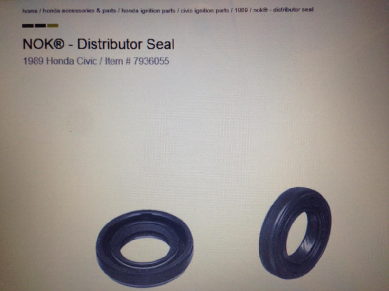

http://Www.carid.com/1989-Honda-civi...m-7936055.html
Would this be the seal you are talking about?

That looks like the style that should be in there. Where did you find it? I did not find it in the Honda parts catalog.

Found searching through distributor parts for 89 Civic at www.carid.com
Is that seal something that requires a complete disassembly of the distributor to change out? It's a $20 part, so I don't mind tearing the distributor apart to save myself $150 - $250 on a new one. Just would like to know what I'm getting into; this is my work commuter and need to set aside time to do it.

Yes, you would have to pretty much strip the dist and remove the drive lug to get the shaft out and have enough room to change the seal.
carid is a sponsor on this site.
See if they have an exploded view of the dist and maybe instructions?
If the shaft has a separate bearing, you might want to replace that too.

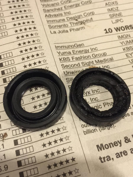

I knew the internet wouldn't let me down! Nailed it this seal is shot...

Re: 89 Civic LX distributor question
Yay!
Good to know. Thanks for the update
