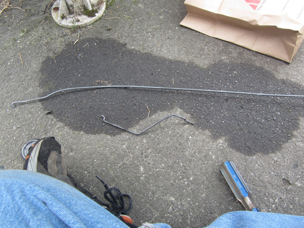

I took a look inside. I couldn't see any way to adjust anything. But I played around with it for a while, and it just seems like the lock was super sticky at one point in its rotation. I tried disengaging the inside lock rod and then the key lock rod to get a feel for it. It felt a little better after spraying the crap out if it with PB Blaster.
I finally just said screw it and took off both of the lock rods, so now it's permanently unlocked. I prefer to leave my doors unlocked anyway.
I also found a spare part that looks like it came from the lock???

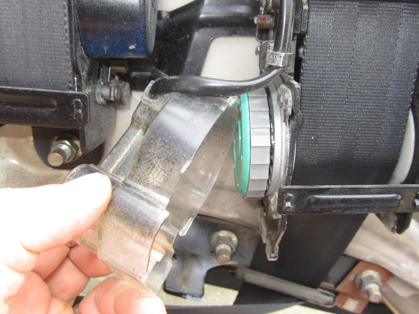

And the seatbelt sensor cover thingy was broken off, so I glued it back on.

Originally Posted by haydeon
That spring came off the end of the lock cylinder.
It is the spring that causes the key and cylinder to return to center when you let go of the key (when all is working correctly).
HTH

Re: Manual Driver Door Lock 1990 DX Hatch
HTH
Thanks! That's good to know. Somebody replaced the old lock, so it must have come from that.
