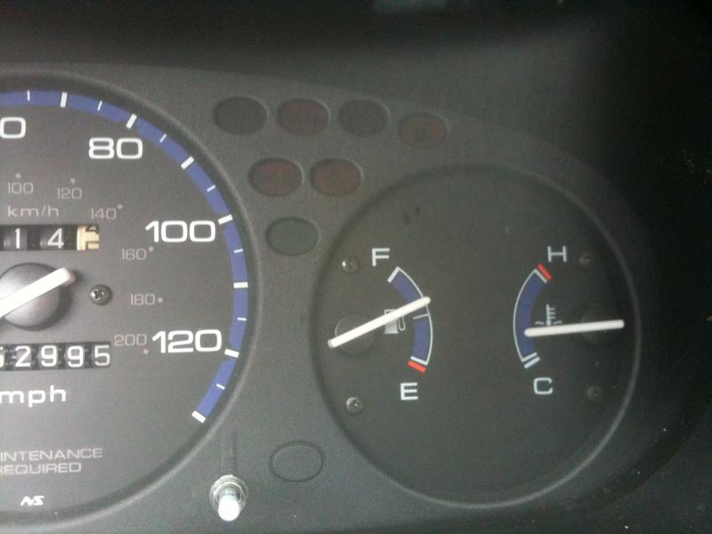

My temperature gauge was going wacky after replacing the head gasket. It pegged out a couple of times. I read that air in the system could cause this so I did my best to purge it of air.
After doing this the gauge was still going up almost max but the fans didn't come on and the thermostat was not opening because I could see no flow down the radiator cap.
I removed the thermostat and put a thermometer in the coolant in the cap. I can now see flow and the temperature slowly rises to about 200 degrees F and the gauge reads almost max.
What is the normal operating temp for a 1990 civic? At what temperature should the fans come on? Thanks kevin

I've removed the t-Stat, and the fans are not coming on at around 202 F. The temp gauge is almost maxed so I don't run it after the gauge goes up that high. I wanted to make sure that 202 F wouldn't hurt the vehicle.

I've replaced it. Also all this worked fine before changing the HG. Gauge never went above a little below half way. Something I did when I removed the head has caused problems. Maybe I got the wires wet. Or broke a wire, blew a fuse etc. The gauge, sending unit, everything was OK before HG change.
I did notice that I cracked the little boot that goes around the wire connected to the sending unit. Maybe I damaged the wire and caused an increase in the resistance of the wire. Thanks Kevin

WARNING: DO NOT LET THE GAUGE GO ALL THE WAY TO HOT, it may damage the gauge.
I replaced the sensor that has the wire coming off that when shorted and UN-shorted to ground makes the gauge act as you describe.
I hope I didn't blow the gauge. I did this ground/unground test before being warned about possibly damaging it by leaving it go high.
The gauge works, just not what I would call normal. And its acted this way before I did the short/unshort test. It began acting up immediately after I started the engine after replacing the HG. It has a rapid fluctuation sometimes that I can't see being actual engine temperature because I don't think the engine temperature could change that fast.

I put the t-Stat back in and ran the car up to around 200 F. The temp gauge was about 3/4 of the way up. The rad fan didn't come on. I turned on the AC and the AC fan didn't come on either. I remember reading about shorting the 2 wires together to bypass the switch and the fan should come on. Is this correct? Also what could cause both fans to not work? Thanks kevin

I still don't like the way the gauge is behaving. If the cars is cold and I turn it on the gauge immediately goes to about 1/4 of the way up. Its also almost maxed out when the thermometer reads around 200F but is not consistent.
There IS a problem.......Ummm....
Is there a ground strap missing from the head or valve cover? (or large ground wire, maybe frayed and broken)

This is bit relavent to this thread. But i am facing similar heating issues with my 99 civic ( i know this is thread for 5th gen, but nobody replied to my thread )
My engine is slightly overheating. I had my older civic where the temperature would stay below the "E" sign but my current 99 honda civic almost reaches the half. So could you please tell me if thats normal or am i goin nuts
The "E" is for fuel level, not the coolant temperature.
The pic of the gauges: Wouldn't worry me one bit. The coolant gauge isn't even near the halfway point in that pic.
HTH
