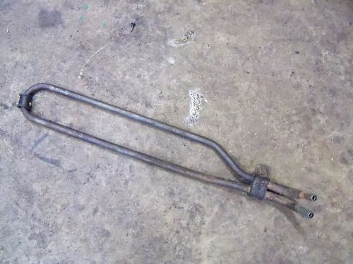

thread from the dead.. sorry i never posted an update on what i found it was..
anyway, upon further inspection i found the leak. who guessed it? nobody! it is the power steering cooler line! ok, so i was exaggerating when i said 10 mins, it seems to last about a week and a half until it starts to whine.. have i changed it? no.. lol i'm about to get a new one though and fix it asap though, although this started leaking a loong time ago as this thread is. looks like it will take a couple minutes to change; possibly removing the front bumper or maybe i can just take the fan/radiator out and get to it. either way, just wanted to follow up finally
oh ya and here's a pic of what i'm talking about. not off my car but this is the line. mine's rusted out plenty; salty winters...
