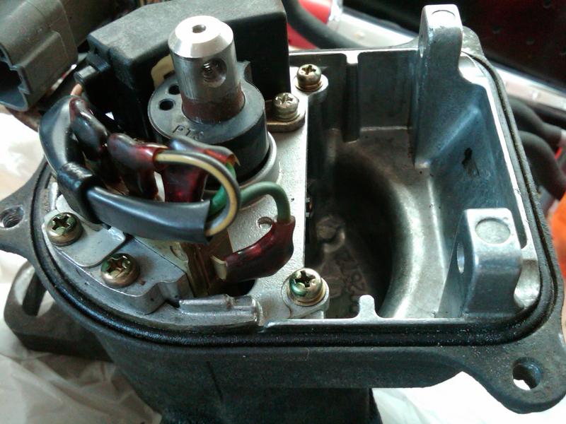

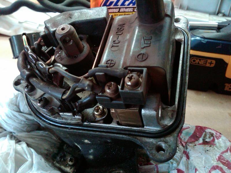

A couple of weeks ago driving my 94 civic DX (99,500mi - 1.5, 16 valve engine) on the freeway the car died on me. I found I had a bad distributor. I found a replacement from a U-Pull-It place. I removed the old distributor and as I was getting ready to replace it with the other one (also from a 94 civic DX - w/1.5 16 valve engine) I noticed the distributors where not the same (see attached photos). The distributor in my civic had a square type box with a positive and negative connection with a stem on it with a spring on the top of the stem. Figuring this was needed I rewired the replacement distributor to have this box in the replacement. I attempted to start the car after replacing the distributor (i also got new plugs, wires, cap and rotor). Car tried to start a couple of times then when completly dead (no start, no lights no nothing). I figured it was a fuse, so I check fuses and I did not find any bad fuses. Assuming the square box from the distributor was the problem, I removed it and rewired the replacement distributor back to its original form. Car still has no power, no lights, no nothing. Am I missing a step somewhere? I'm a house mechanic (which is to say I am no mechanic at all) but I do learn from trial and error (lots of these, lol). I cannot get the car any power at all. Any help will be greatly appreciated.

On the photos below, the distributor on the left is from my civic. The distributor on the right is the replacement .

OK, found a bad fuse (must have missed it) but care will not start, does anyone know what the square box in the distributor is? Do I need it or can I do without it.

I am not positive but I believe that would be the coil pack, and if it is, it is definitely needed for the car to run.

It's the coil, and no, it won't run without it. #12: http://www.hondapartscheap.com/south...t=0&quantity=0
