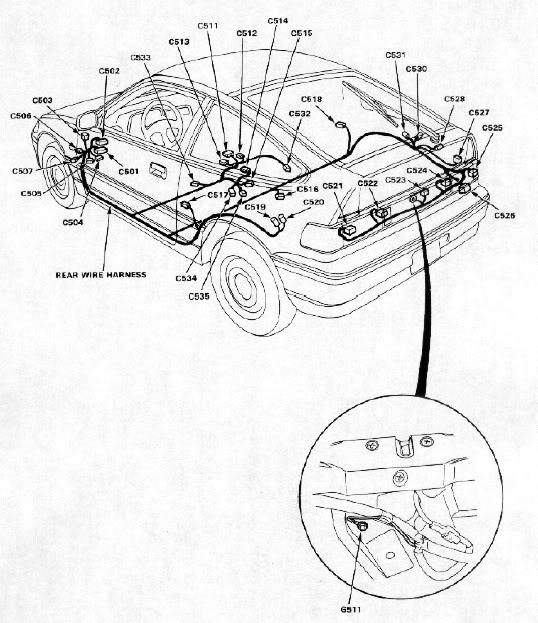

For the problem with the brake lights turning on the dash lights, you either have the wrong brake bulb type installed (should be double rather than single filament buld) or the ground wire for the lights in the rear is disconnected or broken. Start with the former.

Have you checked the rear ground wire and the mechanical timing?

Rear ground wire?. The car is timed we have checked it a few times but i could still be wrong, where is the rear ground wire at?

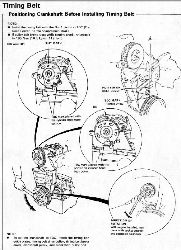

Check G511 and make sure that the cam and crank are synched at TDC1:

i checked the ground wire and it is connected well, i took it off and rubbed it on some sand paper and put it back on, car still does it. i checked the timing and its set dead on, tcd1 Im just confused at this point
