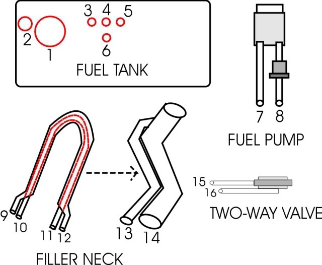

I probably should have drawn a diagram before taking apart the fuel
system, but in my haste to finish this project before winter, I guess I must
have forgotten. Anyway, the repairs have been made and it's time to hook up the fuel system components, but I'm afraid I'm going to need some help.
This tank has far more connections than the later Civics, and figuring out where they all go is going to be a problem. To help illustrate things, I've attached a crude drawing following this post, with numbers beside the various connectors. The two main filler hose connections are obvious (#1 to 14 and 2 to 13), but the rest are a mystery. The strangest thing is an odd series of pipes - one actually inside the other - that simply loops back to the tank instead of going anywhere, which was originally welded to the rest of the filler neck. Neither the Haynes or OEM manual gives even the vaguest illustration of these connections, so I'm pretty much at a dead end.
Any help would be appreciated.
