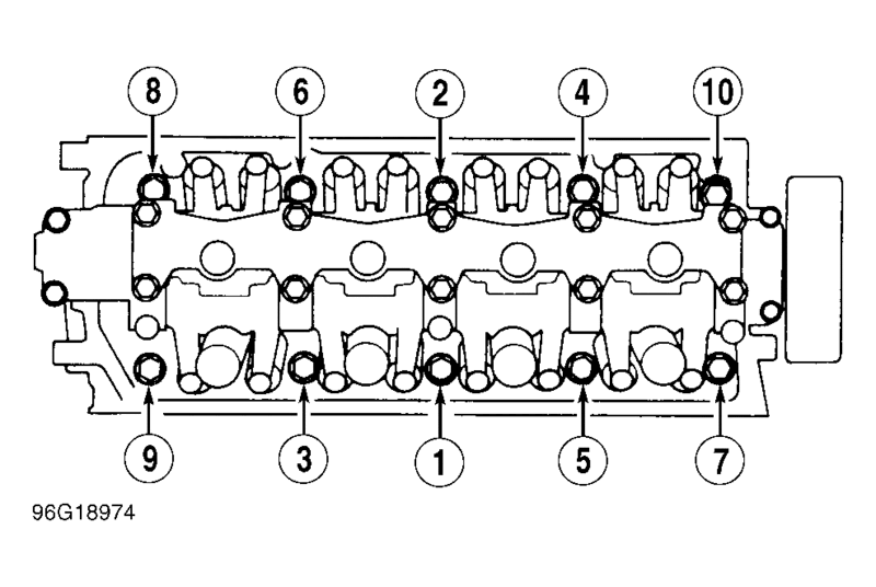

Re: 1986 Civic Si Head Gasket
1. Tighten all 10 bolts to 14-ft lbs. (20N.m).
2. Tighten all 10 bolts to 36-ft lbs. (49N.m).
3. Tighten all 10 bolts to 49-ft lbs. (67N.m).
4. Tighten all 10 bolts to 49-ft lbs. (67N.m).
