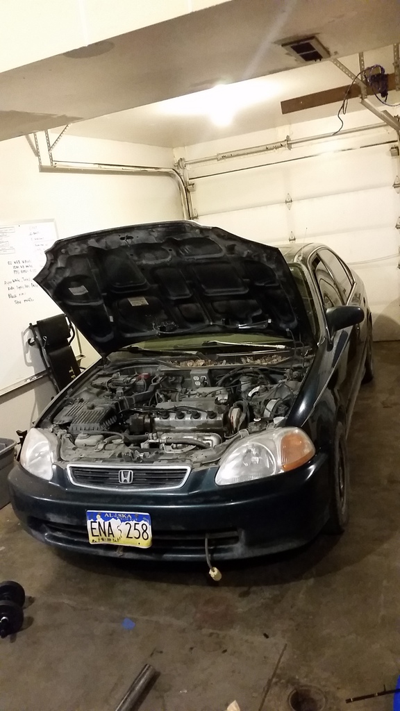

Picked up a free 98 Civic EX D16y8 with bad compressions in cyl 2 and 4 and picked up a good D16a engine for 50. Would be possible to just swap bottom ends and call it good? Just looking to get it back in good running condition without having to tear into y8.
Pick of EX
