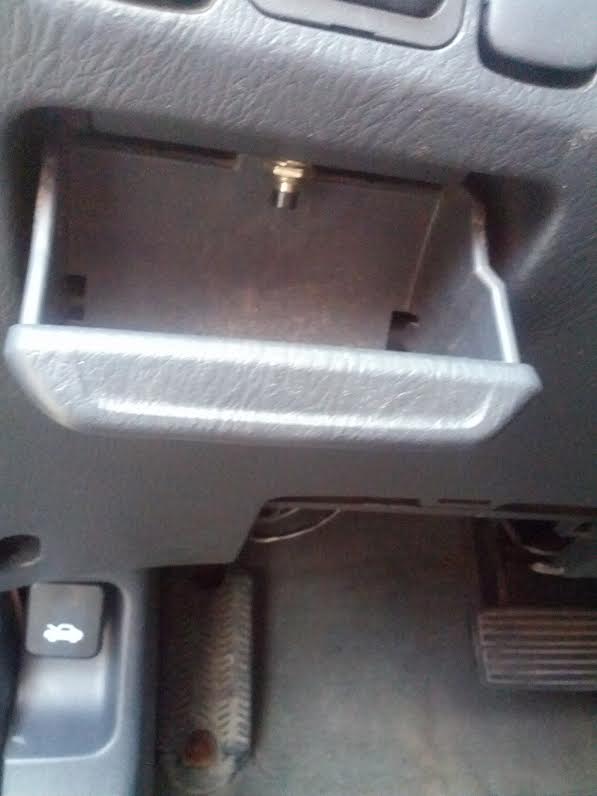

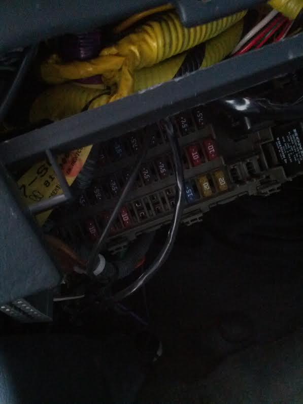

I think it might have a kill switch for the starter and i might have activated it some how. i took 2 pictures, one of this button left of the steering wheel, hidden in a little compartment, and the other is the wiring right underneath looks newer than everything else.

Looks like a valet switch for an aftermarket alarm system.
Follow the wiring to the control unit, see if you can tell who made it. Find that manufacturers website.....
Contact the previous owner? Local alarm installer shop?
Google for something like how to use a valet switch.
Rip the alarm out and restore the factory wiring to original condition?

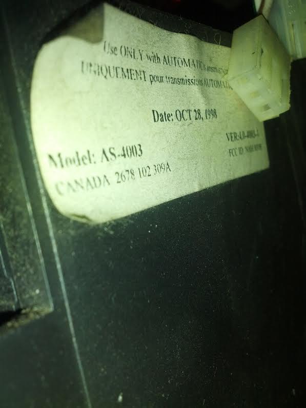

hey, ive been researching valet switches and cant find a trick to disarm it, but i went back to my car and found a box near where my left foot is when i drive, behind the panel, this is it.
it is by a company called arctic start, remote starter and alarm.. but its very old..
Old May 25, 2014
Re: starter dead, or kill switch trouble?
That's it.
Wow man, that's as old as the car!
It's not from Honda.
It might have been installed by the dealer, or been installed elsewhere when the car was very new.
I'd remove it and restore the original wiring to proper order. Or at least patch the starter wire back together so it will crank.
Hell, maybe the alarm stuff has nothing to do with it at all! Could just be a starter problem. Need a little diagnosis to figure it out for sure.
