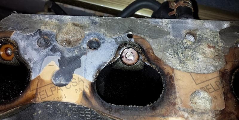

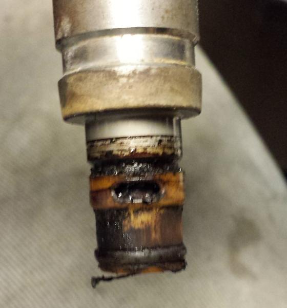

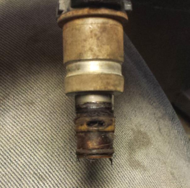

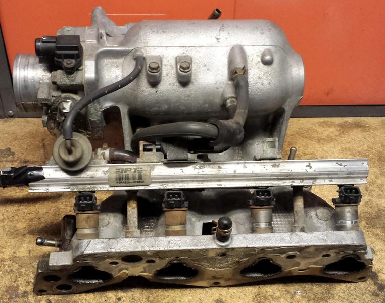

Pulled intake manifold off. Waiting on a new gasket to arrive.
I'm suprised this engine ran at all. bottom middle stud didn't even have a nut on it.
Injectors lookin funky. Think a shot of throttle body cleaner will clean the grime from the tip of the injectors?
2 of the 4 air injection holes was plugged.
Think this massive vacuum leak damaged the cat converter?

Re: D15B Engine
Vacuum leaks aren't the usual cause of a cat failure.
An excess of unburned fuel is.
Unless the vac leakage was causing a severe misfire, I doubt that was the cause.
Usual cause of sudden cat failure is ignition and spark problems, but seeing as how that car/engine has an unknown history and mileage, it's really anyones guess as to what may have happened in the past.
Yes on the carb and throttle cleaner. Lots of it.
You would do good to completely clean out and blow out all of the holes and ports in that manifold, along with all of the injectors, and you probably want some new O rings for the bottom tips of those injectors.
I still can't figure out what you are calling air injection.....
Maybe the air bleeds for the shrouded injectors?
(I forget what Honda called them, but that looks like what those plastic caps on the tips are, see pic below) And that capped off nipple between cylinders 2 and 3, what was it for originally?
Was that part of the air shroud passages?
Figure out the complete system, making it operational again (if possible) might be a good thing, provided everything is even there.
