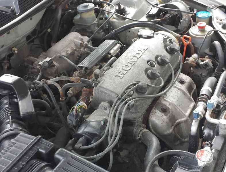

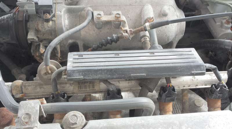

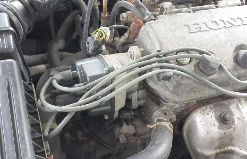

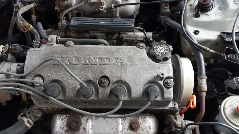

Hello,
Just purchased 99 Civic EX sedan 5 speed.
Odometer shows 117,988 on it.
I was gathering info on it to do a tune-up. One thing i noticed this engine doesn't have an EGR valve. I'm worried about passing emissions inspections. I looked on the block and i see "D15B".
Is this the correct engine for this car?
I just wanna get the right parts for this engine (plugs, timing belt, etc)

Some engines were not equipped with EGR. Look on the underhood emissions sticker, see if it lists one.
D15Bwhat?

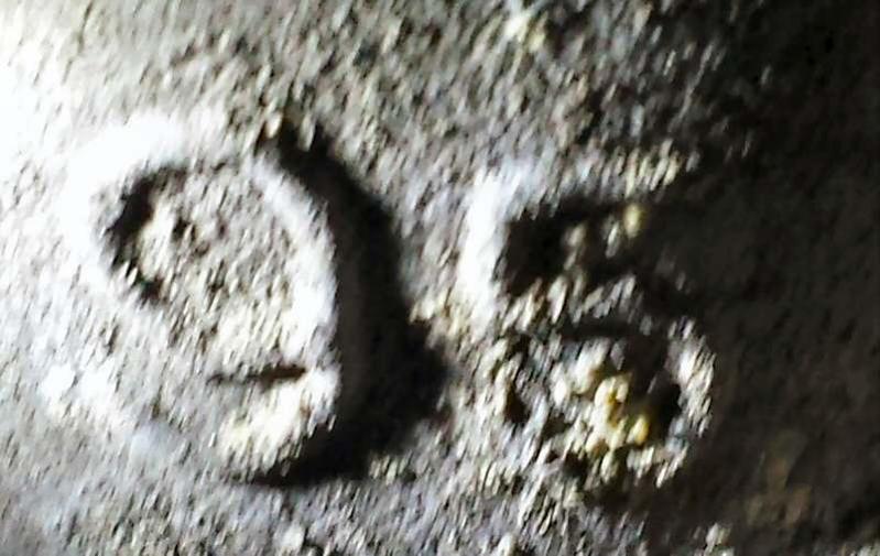

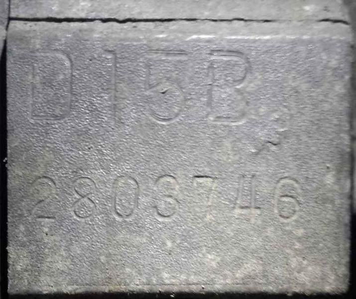

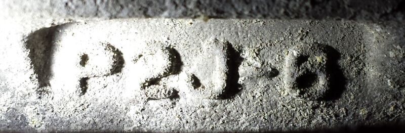

I went out and took some pics of the block and cyl head.to double check..
It just says "D15B" nothing after the "B"
Below it says 2803746.
On the cyl head above the exhaust manifold it says "P2J-6"
Also on the cyl head above the power steering pump it says "95"
Thanks for replying

A 99 ex should have a d16.
I think your engine was swapped with a d15. And from the head code might be a JDM model according to this.
http://www.sohchonda.com/forums/topi...es-head-codes/
* could also be. D16 head on D15 block.

Thanks for the link.
According to that page I might have this
"JDM
THE OBD-II 3 stage VTEC D15B 96^
(2) VTEC solenoids
Head Code "P2J"
year Code "95"
intake mani also stamped "P2J" on the back"
But, I have only one solenoid on the back left of the head, next to the throttle body.

Then you probably have a d15 block with d16 head if there is only one VTEC solenoid.

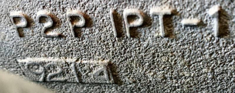

I took a look at the sticker on engine computer, it said " 37820-P2P-A12 "
A look behind the intake manifold said " P2P IPT-1 " below that it shows
921 (4 or a triangle shape)
Name:	manifold number.jpg

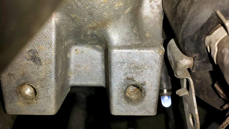

I seen this mounting boss behind the intake manifold below the throttle body.
I wonder what i'm missing there.
Old Jan 23, 2014
Re: D15B Engine
37820-P2P-A12
ECM# matches 99-00 Civic EX M/T
Zoom out a bit, you're too close. I can't see where it is.
You do realize the engines are used worldwide, in different vehicles, and probably even used for applications that don't even involve cars, right?
There could be holes drilled and bosses cast in to cover a ton of different possible applications.

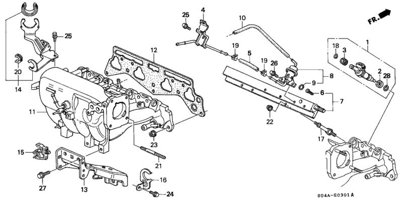

I figured out what that mounting boss connects to.
Number 13 in the picture. Support bracket.
Old Jan 24, 2014
Re: D15B Engine
Better see if bolts can still thread into those holes then, they look like they might be boogered up.
