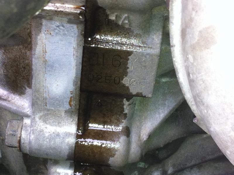

It's a d16y8

Y8 is vtec, but idk if he change the valve cover or head.

Check if there's a VTEC solenoid behind the head,

It's there. When I get tags on it Im going to try and hit vtec and listen for the crossover. From what I heard the ej8's come with vtec and the dx and lx versions don't. I'm still happy though.
