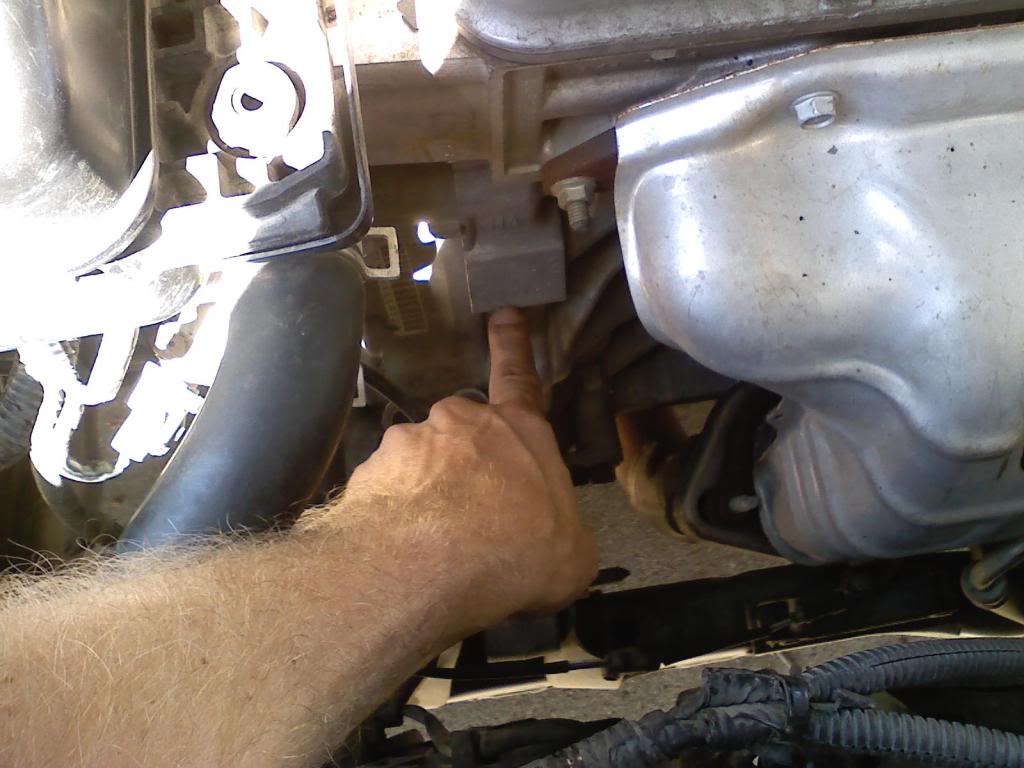

If you like this car then get a new engine and drop it straight in. Ask you're mechanic how much it'll be to get a replacement or find an engine yourself and have them do the labor. Those engines are about $500 used. Try here for a salvage engine: http://www.car-part.com/ If you have to get it shipped it's about $100. Also try local craigslist. Here's one from my local CL: http://dallas.craigslist.org/ftw/pts/2699079057.html '97-'00 EX should all be the same engine (D16Y8).
If you're unsure what engine you have it's stamped right here:
