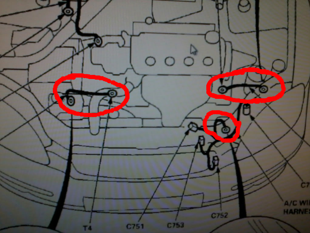

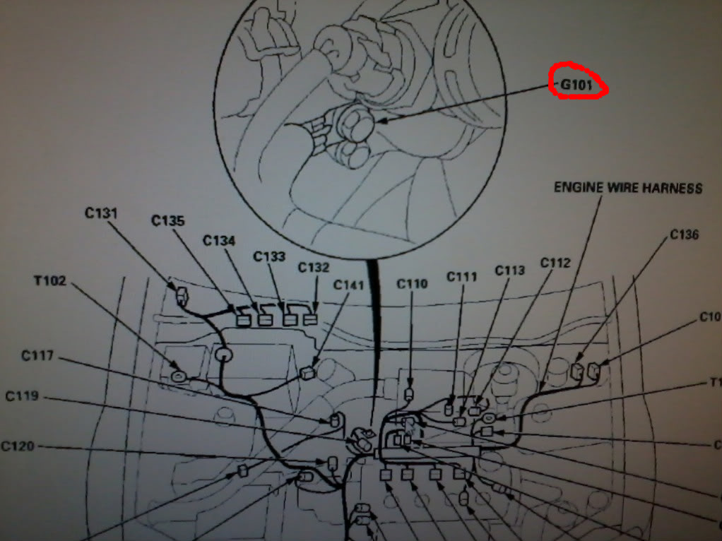

Check and replace any bad ground wires. Next time it rains check for the specific code and we can go from there. Autozone will check the code for free.

ok, i need to know where some other ground wires are that could cause this problem.
i just replaced my battery ground because there where some strands of wire the where not connected and looked a bit green.

awesome pictures! this is great info! now does it matter if i go with a larger gauged wire if i replace some of these? i have lots of 8 gauge wiring and lots of 0 gauge, i am thinking the 8 gauge is what i would go with.

well i think it worked! replaced all the ground wires in the pictures you posted. two of the wires where just junk but could not tell until i had taken them off, the terminals almost fell off in my hand because the wires had rusted and started to fall apart. the connections where not really grounded either. the engine bay had been painted before i bought the car and so the ground wires where just sitting on top of paint and not bare metal. last night it rained here pretty hard and i took my car out for a few hrs and no check engine light came on!
Thanks lazlong
