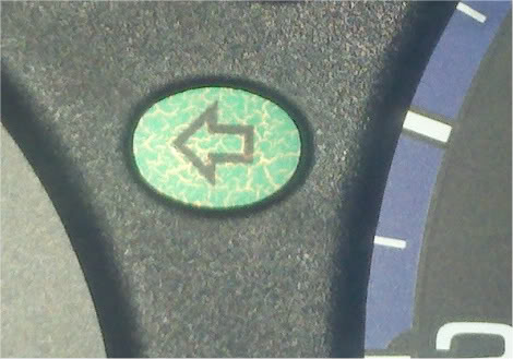

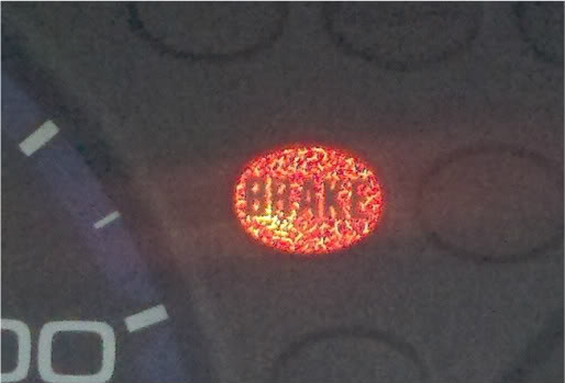

I purchased a 99 Honda Civic DX Coupe this past weekend. I noticed something yesterday that kind of annoys me. It's strictly cosmetic, but irritating nonetheless. The color tint over the SRS, BRAKE, SEATBELT and turn signal lights are all cracked and faded. Can these be replaced? See pictures.

The simplest solution would be just getting a new cluster and swapping it in, I'm pretty sure those are actually painted onto the cluster.

I think they look cool, you would likely need a different cluster.

Swapping cluster is definitely not on the top of my list. They still work. Maybe I'll find an EX cluster.

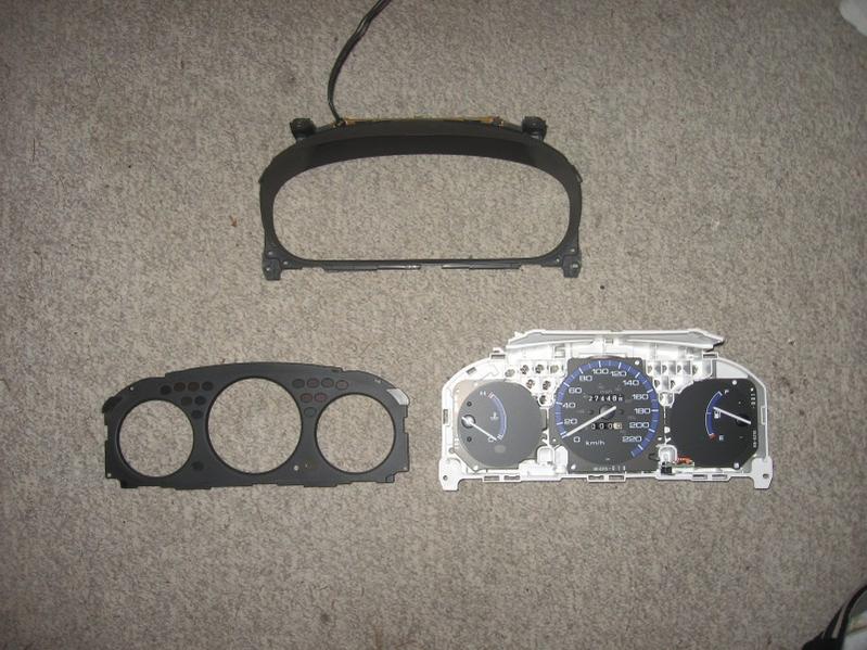

I swapped a cluster out of my 99 civic a few months ago. It's easy.
...but a cheaper fix might be just to take it apart and use a sharpie or something to balance out the colour.
or maybe just find another platter (bottom left).
I dunno just some suggestions.
BTW - you can pop the speedo/odo out of the original cluster by undoing 4 screws on the back

This is the most interesting idea yet

Try the sharpie if you want. If it doesn't work PM me and I can get ya a used platter for super cheap at Pick-and-Pull. I saw a barely picked over '99 this weekend.
