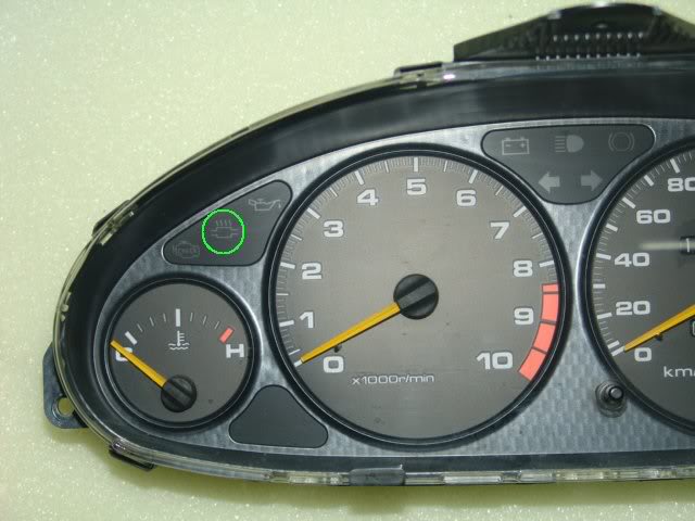

My roomate has a warning light on his 98 civic hatch, he has a jdm type r cluster, it looks like (O)... does anybody know what that warning light means???

I was able to get a pic, but it isn't lit up sadly
Maybe the parking/emergency brake? I honestly don't know. Hopefully someone here with a similar or the same cluster can help you. Going off the way the gauges are set up though, it may have something to do with the electrical system. Fog lights? Lol.
Edit. Here you go, amigo. Took a few creative words to get a good search, but it's the brake light.

he said it looks like (O)
Its the one on top of the 80km/h Mel lol

Re: Need help fast!
That was the photo I stole from Photobucket, Kenny. Get on my level!
Check the second link. The one that's circled has to be the one he's talking about. I mean, I can pop in Gran Turismo 5 and switch to the cockpit view in my CTR hatch if you'd like. Lol.

its the canadian version of the "brake" icon light. means either the parking brake is up (or broken), or you are low on brake fluid (prolly from worn out pads if there is no fluid leaking).

thanks guys, it was the ebrake lol, he just pulled up on it and lowered it a few times and it went away, maybe loose cable hes thinkin
