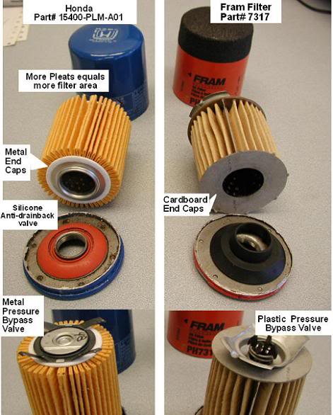

Fram filters are complete garbage. I use hamp filters, they're pretty affordable and most performance shops carry them.
