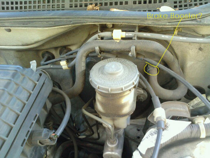

Hi, I have a quick question, need a quick reply. I intend to seafoam the engine later today as my wifes car failed its smog by a small amount and I have 5 days to get it to pass. Anyway, I just want to clarify that this big fat tube is indeed the brake booster vacuum line. I know I need to run a third of the can through very slowly along with a third in the gas tank (not sure I will put any in the crank case)

Cool, thanks, to clarify, that is the correct hose to use right?

I believe that is the correct hose..

Did this yesterday, through the brake booster hose highlighted, used a turkey baster to squirt the seafoam in which worked really well, went off without a hitch, changed the sparkplugs after and everything went ok.
