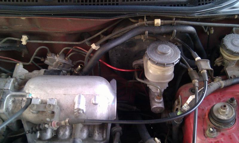

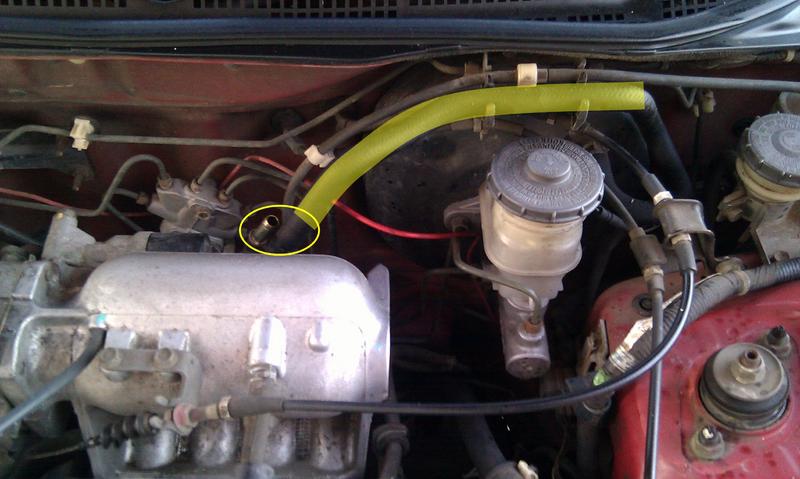

I'm going to wait until the oil needs to be changed again (late spring, I think). And then use 1/3 bottle in tank, oil, and brake booster line. I want to make sure I've identified the brake booster line, picture attached. I can take the booster line off of the little spigot on the mid-back of the intake manifold (I think?) and I'm considering using a turkey baster (like a big syringe) to drip the seafoam in. The 'spigot' is circled in the picture.
I'm fairly sure of the procedure: have a friend idle car at ~1500rpm with BB line off, slowly allow the line to suck up 1/3 bottle of seafoam (In my case, slowly drip the seafoam into that metal tube on the manifold), stop car, let sit for half an hour, drive spiritedly (which will be difficult for me in my small suburban city Tons of police).

I went back and looked at the tube I highlighted in the picture, and noticed that there is no check valve on it, which is mentioned along with the brake booster quite often. A smaller, flimsier (like, aquarium quality) hose is directly behind it, visible in the picture. This does have a small check-valve-looking-thing, and is connected to the bottom of the intake manifold.

You can go to the sea foam website and they have quite detailed info there on how to do it. The overall procedure is 1/3 brake booster, 1/3 crankcase (engine oil), 1/3 fuel tank.
Personally I do use Seafoam and I quite like it. However, I don't do it in the brake booster or in the engine oil. If you pour it too fast into the brake booster there is a very real chance you can hydro lock your engine. Which means you'll have to replace the engine and I don't trust myself enough to gamble an engine on it. The idea of pouring alcohol into oil is just ridiculous to me so I don't do it in the crankcase either. Every fall I treat 1 full tank of gas and I run it down until my gas light comes on as a regular maintenance approach. I've done my Civic twice now and all is well.
You just have to understand that Seafoam is not a miracle cure for an old tired engine. If that's what you are doing then there is a very real chance that the Seafoam will dissolve carbon that is in essence keeping your car from burning/leaking oil. It's not Seafoam's fault.
I really love the stuff in 2 stroke engine's, lawnmowers, weedwackers, dirt bikes, etc. I guess they just sludge up faster with mixed gas and a bit of Seafoam makes them run like new again.
