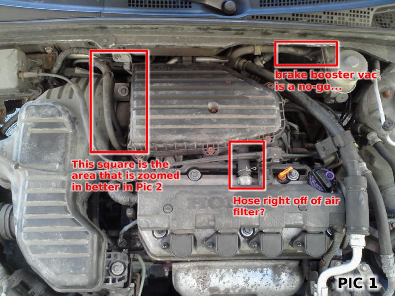

Even if it doesn't quite solve the original problem of the CEL I have been trying to do the Seafoam in the brake booster vac hose treatment and for the life of me I can't see how to get any of the hoses off. Her brake booster is 4-5in under the windshield a bit at the top of the hood and it took me a good 20min just to slide the metal hose crimp thing off. After yanking and examining the hose itself connected on the metal nozzle part, it seems impossibly tight and almost fused onto the metal - I guess because no one has touched it in 11 years...and I don't know how anyone would ever get it off...

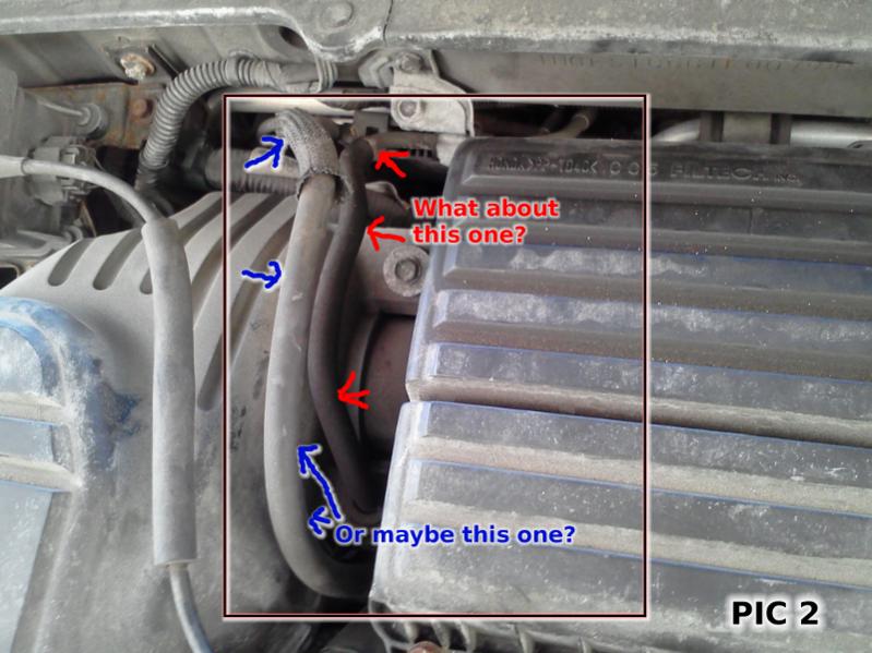

I have been googling various other places to administer the Seafoam into the manifold that may have easy accessibility and have read that the PCV valve and the throttle body might be two other potential access points?
However, I have no idea where these may be located. I read that the PCV valve might be even harder and I might have to get under the car? I can't find anything that looks like the copper metal head of the throttle body hose that I have found on googled pictures of other civic generations under her hood.
Can anyone provide advice on another way to get the Seafoam into her manifold? Can I use the giant hose directly off of the air filter? Where is the throttle body? Any other hoses or ways to easily inject it in? I have pictures to reference to illustrate my confusion and hopefully someone can point me to something in these pictures that I can use since I am car illiterate.

Needs a cat.

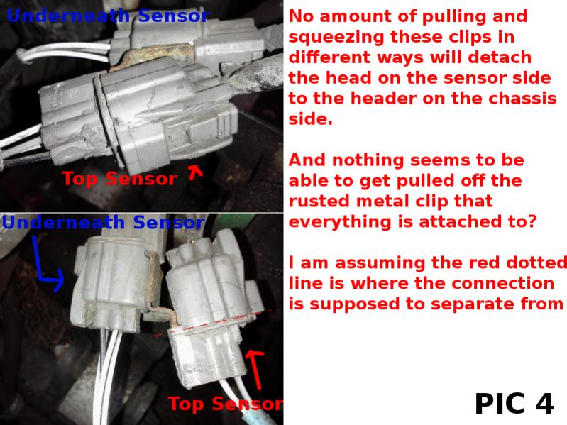

If you are struggling with connectors, you might want to just leave the entire job to the pros.
HINT: There is a lock tab that must be released to get the connectors off of the metal bracket.
There is another tab to separate the connector halves.
