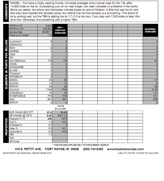

OK, so here is my oil analysis, as promised on a prev.post of mine in this thread.
5,300mi on oil. Chevron Supreme 10w30 SM GF-4
The insoluable level is a little high even though I'm using a Purolator Pureone oil filter, Wix fuelF and Purolator Classic airF.
