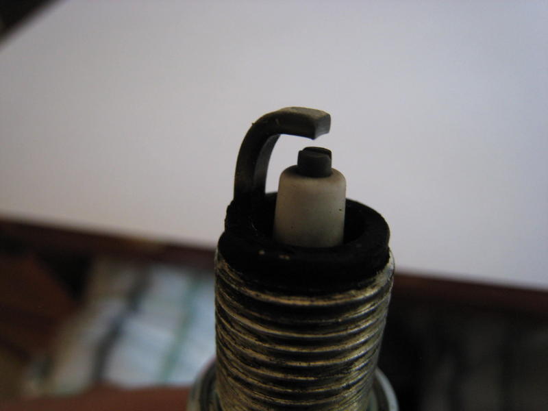

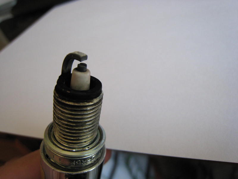

I was just wondering if this is what spark plugs should look like. The electrode is fine but does all of the black soot on the threads mean anything?

too rich a fuel mixture.

Thanks! I've suspected a bad oxygen sensor for awhile now so I just ordered one. Hopefully that will fix it.

Just installed the new o2 sensor today. Car is running better so hopefully that'll fix the rich mixture
