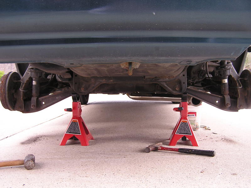

Now that I finally have my rear disc swap done I was looking into doing a 19mm RSX rear sway bar on my 1998 Civic LX to compliment the 22mm stock bar up front.
I've been told you have to do some drilling (because my model did not come with rear bars from the factory) and you also need subframe reinforcement (I was going to go with the ASR brace)
I'm new to suspension and I'm not exactly sure how everything fits together.

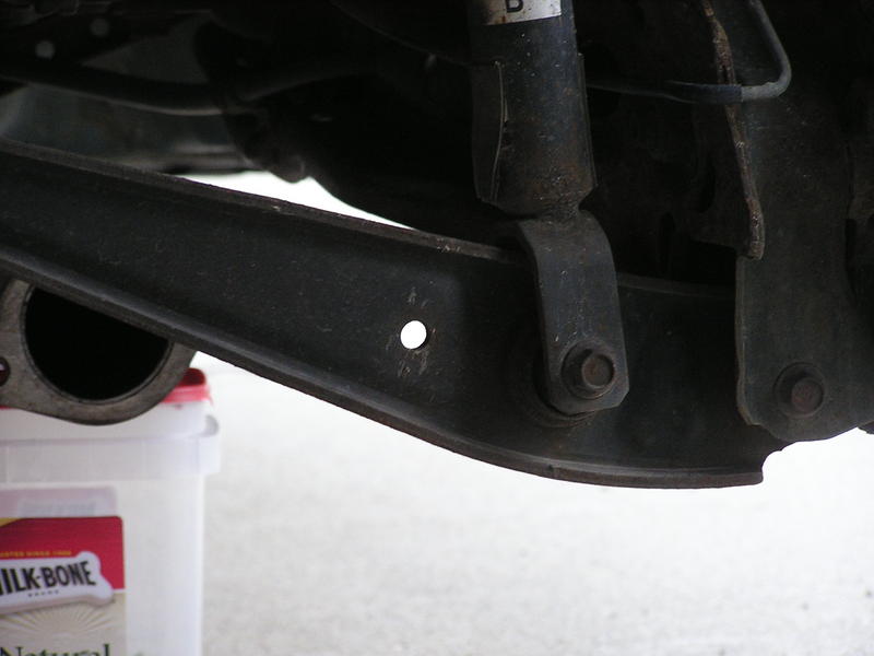

Can someone tell me where the endlinks attach? Do they attach to that hole in the lower control arm? (pictured) or is it somewhere else? Where can I get endlinks that will work? Will Grey's endlinks work, or should I get stock ones from a RSX?
I've also been told you have to drill out the existing subframe in order to attach the sway bar mounting brackets. It appears that my car already has these holes (directly above jackstands in pic)
Any advice/explanations would be GREATLY APPRECIATED!!

You can bolt on an OEM 99-00 Civic Si bar as your car was manufactured with all holes/mounting space and bracket mount holes. I highly recommend this bar as it's not too large (14MM) as larger=oversteer especially in compromised grip (winter/rain etc). Plus it will definitely not rip out the control arms or mounting points on the body.
RSX will be much larger and the end links will be completely different, as were the Integra's.
Good luck.

Really????? That is amazing news! So all I need is the mounting brackets, bar, and endlinks?
(I found the endlinks at Beaks Products)
My car won't have the nut welded in there like the Si did. If I go to the Honda dealer and get the hardware will the bolts that hold the D-bracket on be long enough to put a nut on the end of?
http://www.honda-tech.com/showthread...=371907&page=2
(post #6)

1. Screw the RSX bar. If I got that then I'd have to go with the subframe reinforcement....this girl is just a DD
2. I was looking at getting parts from Majestic Honda
Does anybody know if I need that spacer?
(part number 30 http://www.hondaautomotiveparts.com/...REAR+LOWER+ARM)
I'm assuming I do

Bar, brackets and end links. The nut comes with the end links and it's seriously a 20 minute job the first time you do it. The nuts are not welded on any of them as they all used exactly the same lower control arms.

What about Part #30? You can see it on Running Riot's post Fond Farewell: Goodbye Frankenstein (https://www.civicforums.com/forums/1...nkenstein.html)
It's about half way down, the shot with the rear LCA
