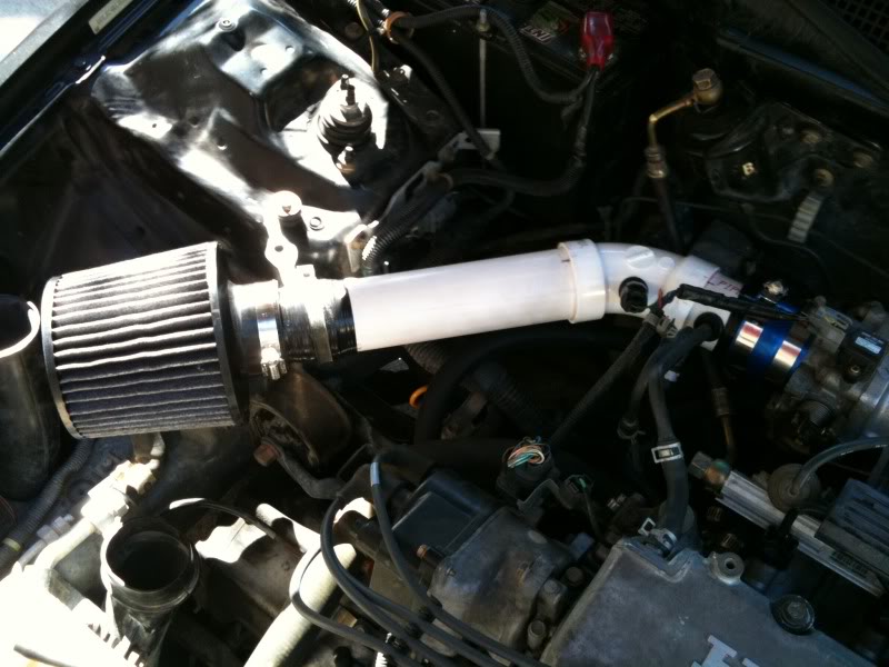

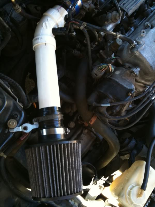

You should check out an AEM cold air intake, and or if your creative try and make your own.....Name:  7edd4b88.jpg

btw I made this one ( it's a short ram) but I also bought me an AEM Cold air intake

I would do Intake (AEM V2 with dryflow filter) header and exhaust first. This gets the car breathing better.

EDIT: PVC shouldnt be used on the intake because when it heats up it lets off nasty crap thats not good for the motor. If you wanna bend some metal an make your own- go with either aluminum or stainless steel piping and use a pipe bender to get the desired shape or bust out a welder. I'm always in favor of something custom because you learn to appreciate the product and workmanship that goes into it, plus u get that added sense of customization.
..... Others probably won't recommend it but eh,
that's cool that people think of new ideas like your making a home made intake cool.

Also, Honda1996 is correct, PVC can give off chlorine gas when subjected to high heat. Not good.
