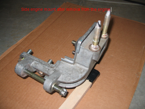

Hello,
My my car started shaking and there were also lots of noise coming from the engine area.
Today while taking a look to see where the noise was coming from I noticed that my driver's side engine mount was missing the poles/
Anyone know where I can obtain a new replacement part?
I have looked online cannot find anything.
This is the part I'm looking for, mine has both poles missing now:
https://www.civicforums.com/forums/a...0&d=1501475075

Part #1 on this drawing (Honda part number 11910-PLC-010:
Here's a link to buy, costs ~$43 plus shipping:
https://www.hondaautomotiveparts.com...unting-bracket
I don't quite recall if ordering that parts comes with the two upright bolts (the poles you referred to). I had to order one a few years back, and if my memory serves me correctly, it did, in fact, come with those bolts. However, if you decide to order the bracket and forego ordering those "poles" and you end up needing them, the part number for those is 90380-S10-000 and they cost $6 plus shipping each.

How in the hell did that break? Should check the other ones as well. Rockauto might have it, I know they have the other ones. Otherwise dealer or junkyard

I just went through this also, I would HIGHLY recommend replace all engine and transmissions mounts (4 total) and replace the bracket as mentioned in above post.
If you just replace the bracket and all the engine mounts are still worn out you will just stress this bracket again and strip out the studs again.
No idea, the shaking and noise started about a month ago when we had a sudden snow storm.
The car has been stored ever since, I just now had time to take a look at it and the brackets were the first thing I noticed.
