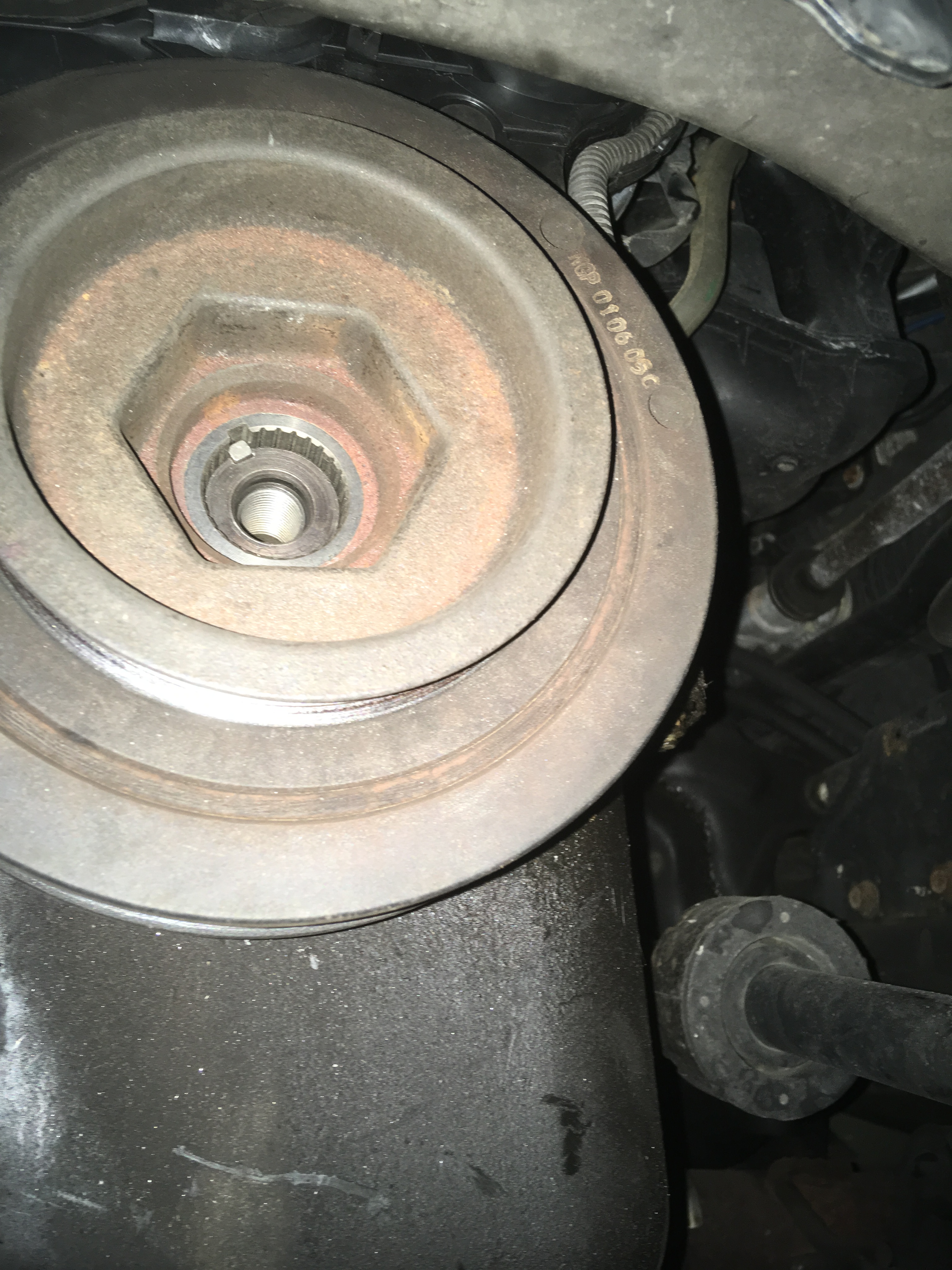

See attached pics.
Does the pulley go on any further than shown ? It's been about 3 weeks since I pulled it off to do the timing belt.

It's been so long but yes I believe it does. If I remember correctly I used the crank bolt to help press it in further (I didn't do a fully tight to spec just tight enough to pull it in more then removed bolt and checked).

I think so. Try tightening the crank bolt and see if it pulls the pulley on any farther.

It will make a solid clunk sound when you put it on all the way.
