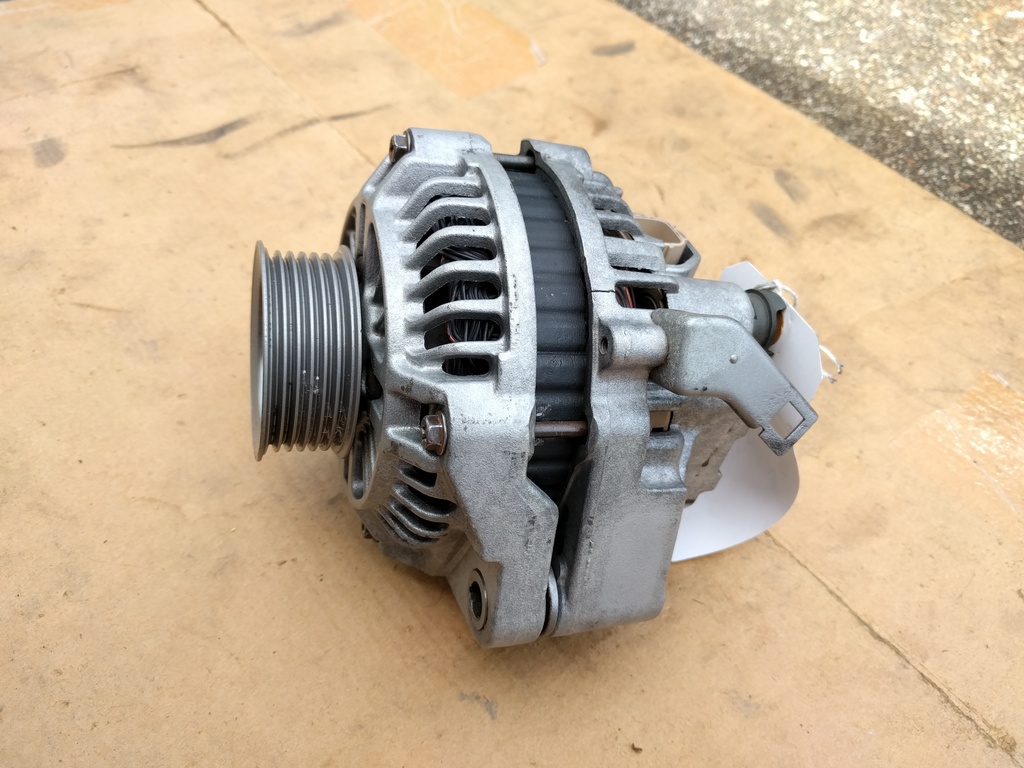

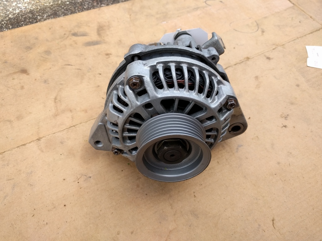

I took the alternator in to a local alternator specialist and had it rebuilt. 180K miles on the original brushes is pretty good, $97 later here is it is:

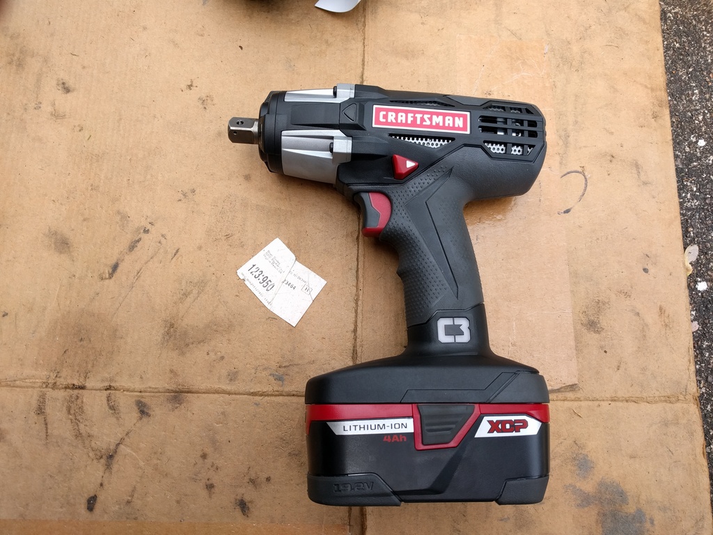

I bought a cordless craftsman impact gun and it easily removed the crank bolt.
