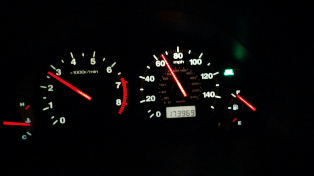

My 01 LX 5sp runs 70mph around 3k rpms. I will check next time i runn70kph, but it for sure is closer to 3k than it is 4k rpms

I was more focused on my driving and its not a great shot, but it shows I am doing 2600 RPM in 5th at 65 mph.

Ex and dx/lx have different gear ratios
