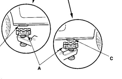

here are the jacking points attached; on the rear you can jack at the tow hook. also the whole edgy line at both sides of the car is very solid so you can jack and place jackstands anywhere along it
ID:	87041   Click image for larger version
