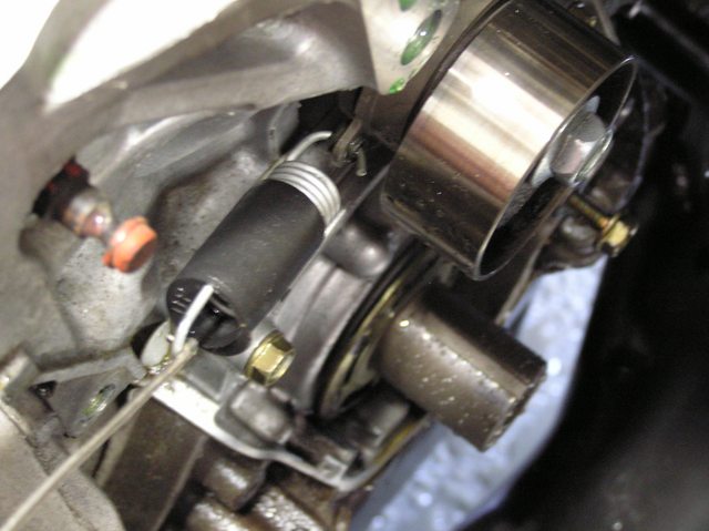

I sure don't have to remove it to take the head off. (I've said this before.)
I can remove the upper timing cover, take the spring off its peg, slip the timing belt off the cam gear to the side, never remove it from the engine..
Kinda like this
Alldatas labor time guide allows less than one hour additional labor to replace the timing belt along with the head gasket job.
I disagree with Alldatas labor estimate for this particular item, it should be higher.
But the shop wanting an additional $500 for the timing belt is out of line IMHO.

how can you make sure the teeth on the belt are properly inserted into the grooves on the crank pulley and water pump pulley during reassembly?.....you can't
how can you make sure the timing belt spring is still properly inserted into the tensioner during reassembly?.....you can't
i also would not trust lining up TDC on the crank without being able to see the marks on the timing belt drive/crank pulley,
there is too much uncertainty and risk doing it that way for my liking,

I was pointing out that complete removal of the timing belt is not necessary to complete the head gasket job, no matter what the FSM says.

And to the contributors: zip-tie the timing belt to the camshaft pulley in two spots at the top of the pulley. Then simply take the bolt out of the camshaft and set the pulley/belt assembly to the side. You don't need to loosen the tensioner or fight with the t-belt during reinstallation. You also wont bunk the timing/teeth with this method. Done this way you won't screw it up. Even if you're a moron.
