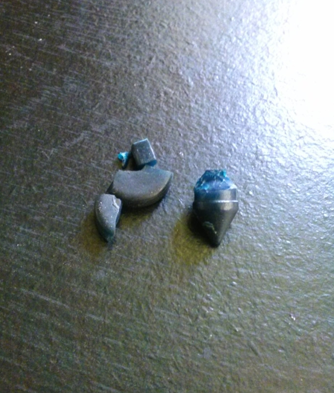

Look to see if piece #13 is still attached to the brake pedal. It's a little white plastic piece that pushes against the brake light switch to shut them off when the brakes not depressed. I've seen them rot and break and fall out of the hole. There could be remenants laying on your driver side floor board some where.
Piece #13 below.
Piece #13 below.
This was exactly it! I would've never thought a switch like that would depend on a piece so fragile and easily wearable 46505-SA5-000 PAD, PEDAL STOPPER
As shown here: [code]http://www.hondapartscheap.com/parts-catalog/honda/civic/2001/2dr-ex/ka4at/chassis/pedal[/code]
However I ordered it from eBay a bit cheaper, and hopefully shipped faster ( I went to a few local junkers and places that sell all kinds of parts but none had it):
[code]http://cgi.ebay.com/ws/eBayISAPI.dll?ViewItem&item=111017685992[/code]
Thanks a lot again, I really appreciated!
Just for kicks, a pic of the ol' retired pedal stopper:
