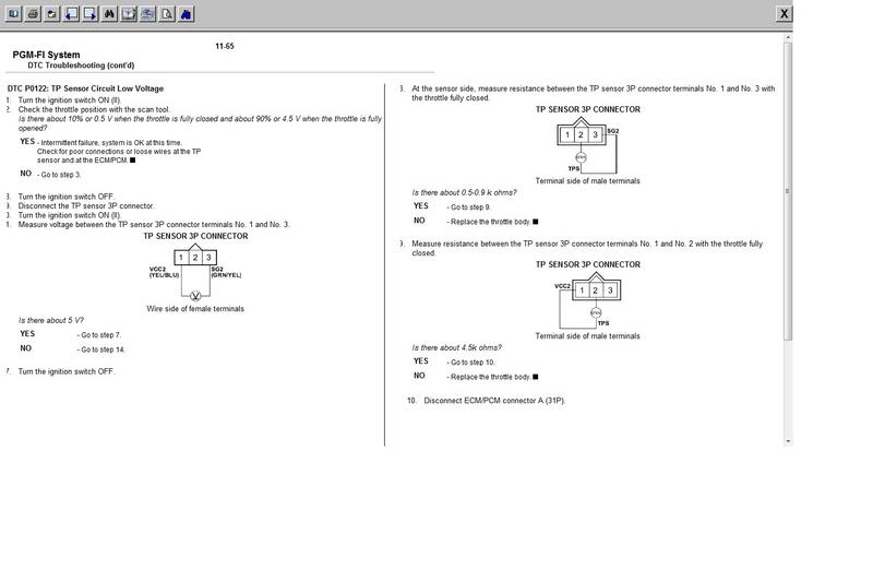

I tested the TPS sensor again as per the factory service manual, (see attached page from the manual), What do you think of these results:
[I opened and snapped the throttle shut several times while taking the readings and it did not make a difference.]
Resistance between pin 2 and pin 3 on the TPS sensor was 0.886 K Ohms. Manual says it should be between 0.5-0.9, so this seem ok
Resistance between pin 2 and pin 1 was 5.75 K Ohms. Manuals says it should be 4.5 K Ohms. This reading seems a little high. That's more than a K Ohm of resistance. Isn't that a significant amount when we're only dealing with 4.5 volts and only fractions of an amp in current?
Since the earlier voltage tests by back probing the TPS sensor appear to be within range (0.48 V - 4.69 V), the high resistance implies a higher than normal current load across that circuit, but I'm not sure if that would cause an erratic idle.

...............................Ummmm.......If you look at a wiring diagram (I randomly picked a 1995-97), the fixed resistance is between terminals 1 and 3. Terminal #2 is the sliding contact and measurement will change/vary with throttle position when read using either of the other contacts as a reference.
I can't tell you an answer about the resistance other than "maybe".
My opinion is that "I doubt it", but your results are not "by the book" so...do whatever you want. (Borrow one from a good car and try it!)
Here's why I think that:
The computer doesn't read/measure or use resistance of the sensor, it reads the output voltage. That's the only wire directly read inside the PCM, that carries all the information the PCM can use.
The other two wires attached to that TPS, (5VREF and sensor ground), are shared among other sensors.
My thinking is that as long as the voltage output is correct for any given throttle opening, it should be good.
But I also know it doesn't always happen that way, a skew of the output voltage readings at a partial throttle position is very difficult to determine even if you have another identical unit in your other hand to compare to. There isn't a special compass tool for charting opening angle vs. output voltage that I have ever seen. (At this point is becomes a diagnosis by process of proving everything else good.)
Something else here: When I am looking at stuff like this, I want to see what the PCM sees. That means a scanner and datalist.
Voltmeter readings by hand testing might not perfectly agree with values as seen by the PCM for various reasons (you are using a different ground point, sensor ground comes from within the PCM). When a value of .01v change can trigger some certain action, I want to be right in there to see it.
The PCM uses the 0.49v value to enable "idle program" conditions. It might turn those conditions off at 0.53v (random number!)....so if you aren't measuring exactly as the PCM measures, you might come to wrong conclusions.
If your TPS reads too low, you might be able to significantly open the throttle and cause the surge only because there is too much airflow and the idle programming is still in effect.
Make any sense?
The only thing I really ever consistently used resistance for when checking a TPS was a "sweep test", to make sure it didn't have dropouts or that "scratchy volume ****" effect when moving the sensor very slowly throughout its entire range of movement.
If the output voltages of a sensor are way out of whack, than I might pull out the ohmmeter to see why, but I gotta have a reason to go there.
Any 3 wire sensor generally uses a ground, a voltage (5v in this case), and a signal return (output voltage). A general rule of thumb for the vast majority of all manufacturers was .5-4.5 working range, give or take a smidgen. The general ranges from 0.0-0.5 and 4.5-5.0 were used to tell if the sensor or wiring was causing the voltage to be out of acceptable range (internal self diagnostics).
However, those are not hard and fast rules. The outer extreme ranges can be minimal as long as the PCM can recognize an open circuit and a short circuit as determined by the signal return voltage...they could use 0.2-4.8 and still be able to tell open or short if they wanted to.
99% of Hondas TPS are set to give 0.49V at closed throttle, and WOT is whatever it is.
(GMs used to spec 0.44v at closed throttle on some cars.)
