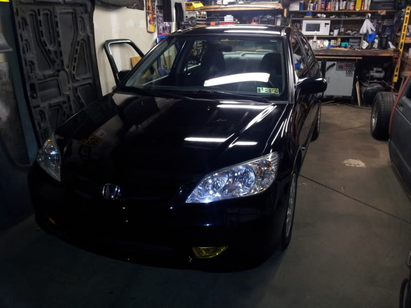

I pulled my C10 out of the garage I rent (with 2 friends) and pulled the car in. Good place to start right?

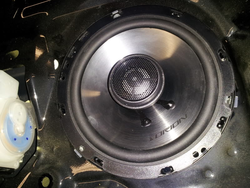

I lined the speaker up but only 2 mounting holes matched up

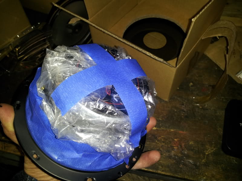

Before drilling I wrapped the magnet in plastic and tape so no metal shavings from the rig gets on the magnet.

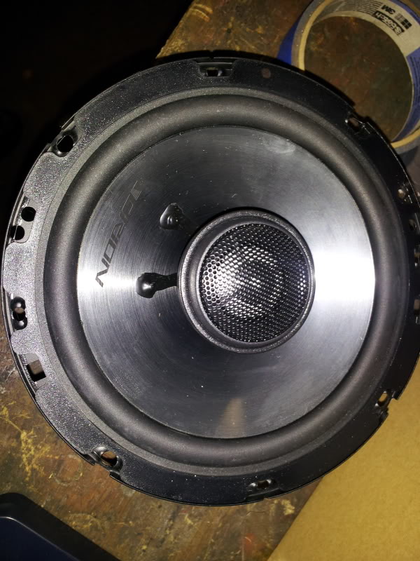

Bada bing, third hole lines up.

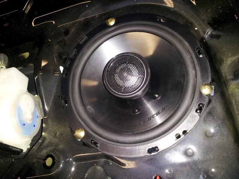

Using the stock screws, the speaker fits like a glove.
