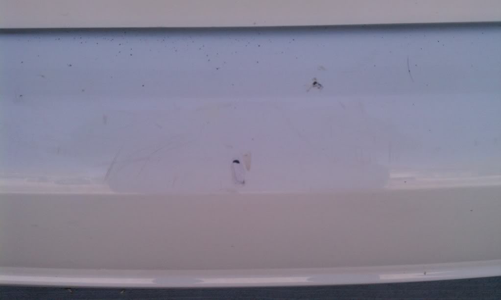

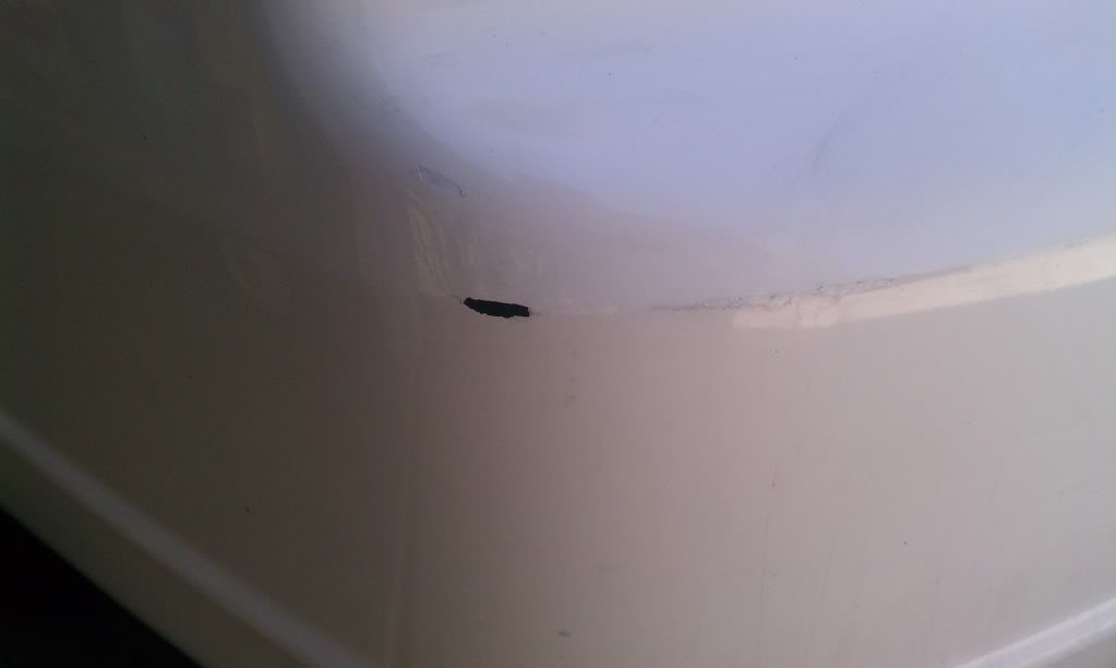

So the previous owner of my ES2 was a teenage girl. I need to repair the damage that was caused by a few bumps to the back of the car(all cosmetic). I was wondering if sanding/priming/then painting would be a viable option for these knicks? Any input would be greatly appreciated.

I would. How would you go about painting it? For me personally that isn't enough to get a shop to do it, or to use a gun. Try picking up some matching Dupli-Color from your auto store, and rattle can it.
Thats what I was thinking. I just dont want it to look cheap and ricey

The dupli color should be fine as long as you prep the areas first, and not just go nuts and spray every knick you see in sight. Now if you're going for the ricey look ...go ahead and go nuts every where , include some neon colors too while youre at it, lol

try to buff it with a rubbing compound to see how much stuff comes off. then whatever areas are showing try touchup paint, let it dry, then buff again to blend it. will look pretty good but nothing like a full spray job at the shop.
