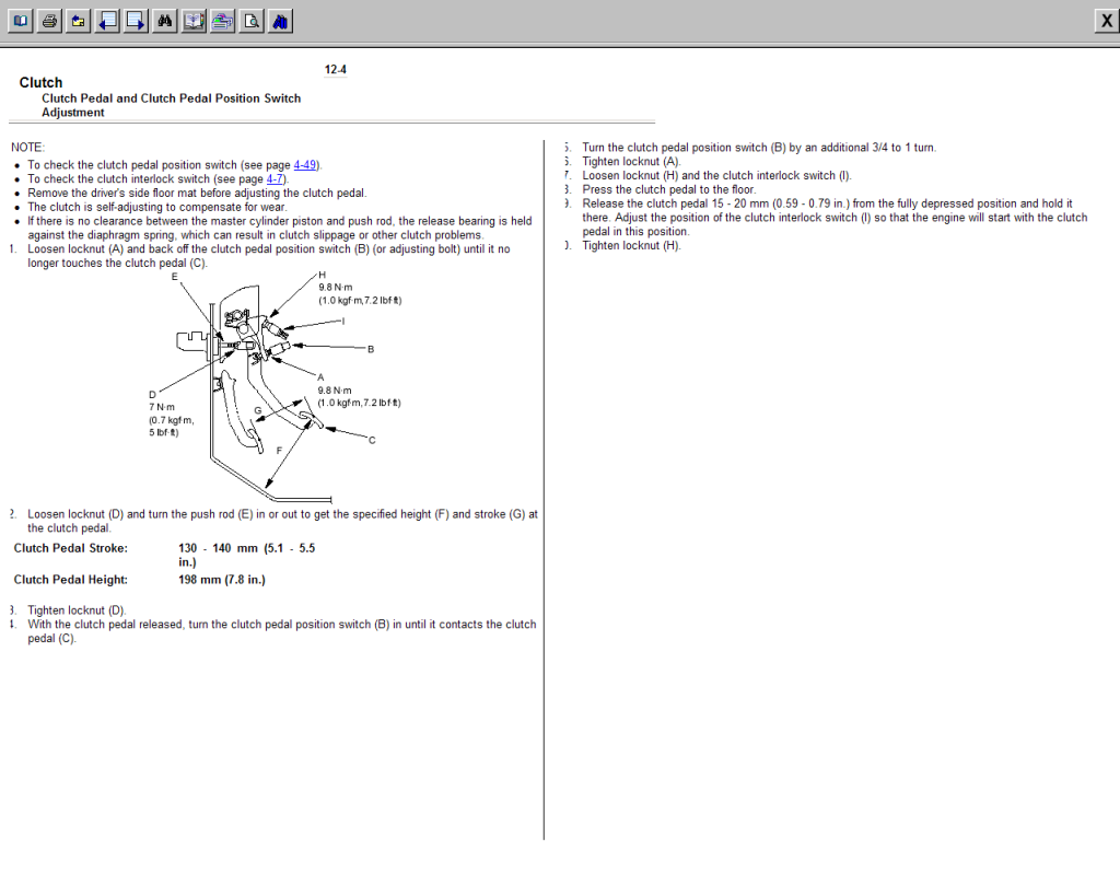

The switch should be right above the clutch pedal. The pedal should come in contact with it to make the car start.
Old May 2, 2011
Posts: 15,189
Likes: 1,609
Re: Urgent: Car won't start
sorry, i was off-line.
here:

^oooo nice.. my bet is it's still the battery
