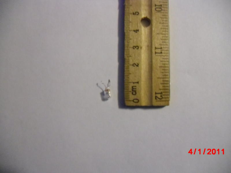

I am trying to change the bulb that is out in my powered mirror switch. They want $25 at the dealer for the switch and dont sell the bulb seperate. I already de soldered it and I just need to find out what kind of bulb it is.

It looks like this once removed

convert your stuff to LED! Lol.. you're halfway there already, so might as well, right?
http://www.ledautomotive.com/guide.php?id_cms=54
some 3mm or SMD LEDs and some SMT 470ohm resistors and your're set. A supply of 26ga solid wire is good to have, too
as for the real bulb size, got nothing for ya.. sorry.

nah I wanna keep it stock looking, dont wanna change just one to led. Thanks though

When mine died I sacrificed a similar bulb size neo wedge bulb and soldered it in place. Just uncoiled the 2 solid wire leads and it came out of the base easily. Sadly I don't remember which part # I used.
Radio Shack has some "grain of wheat" bulbs that may work. You have to test the brightness 1st.
