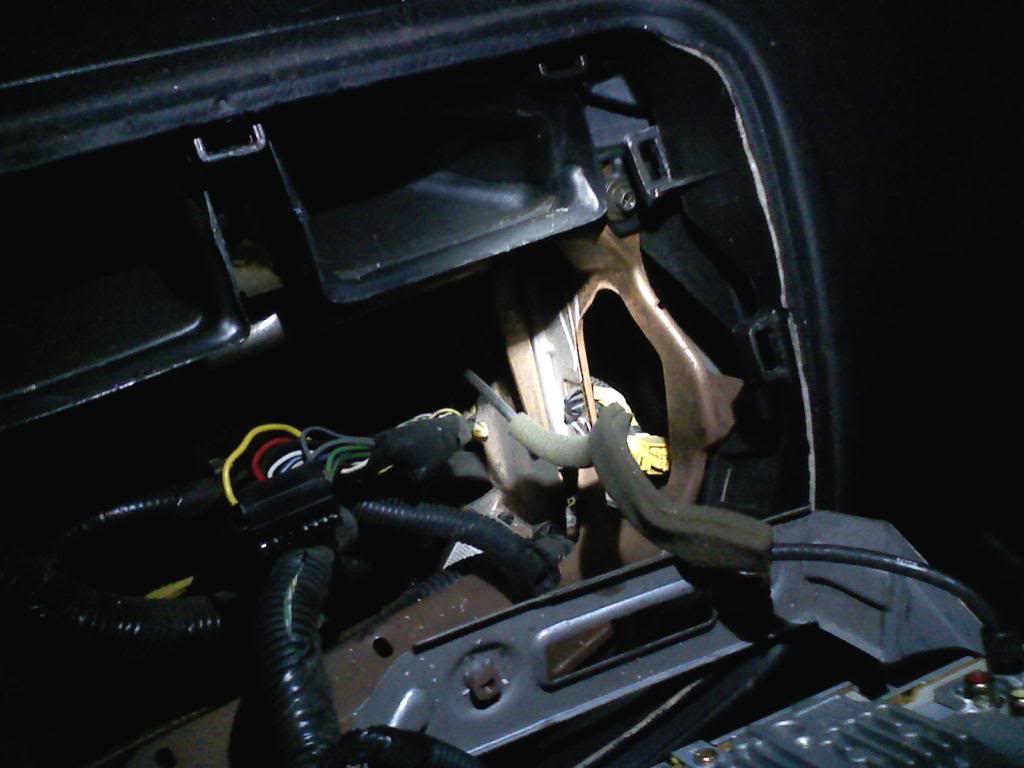

2001 EX coupe. Bought it salvage in January 2007 for $2000. Thought it was a pretty good deal as KBB was $7200 at the time. I could tell that the core support had been welded back on. Looked to be a quality job tho, all the panels lined up and everything looked in place otherwise. It's been a pretty reliable ride so far. Sound mechanically and electrically for the most part, except for little stuff. Now, for the scary part. Tonight I pulled the center console to investigate the audio plug (from the other thread). After taking my pictures, I was about to close it up when I noticed a little yellow plug...
Upon further investigation I found that the passenger airbag isn't connected or even there (the module is there but, no airbag itself).

yeah its really hard to figure out what exactly happened that caused a salvage title. sometimes its just body repair work which is completely fine, other times it could be more serious and theres no way to know for sure without stripping the entire car. and even then, it could be mechanical. if that srs plug is disconnected, makes you wonder what other stuff like that you dont know about. im also wondering how they were able to disable the srs light on the dash from coming on. did you check the connectors under each front seat? make sure the tensioners work. airbags arent as big of a deal as the tensioners.

Checked the tensioners, they're fine.
After talking to some people, apparently this is a favorite trick of rebuilders. You solder in a resistor so the SRS unit thinks there's an airbag there.

ah okay yeah makes sense considering one airbag is over $500. if oyu really wanted them, you may take a chance on a used bag on ebay so long as it looks new. alot of those were taken from junked cars where the airbag never deployed.

its normal for light to come on and then go off as part of the self check. if it never comes on, its prolly bypassed. the seatbelt tensioner there is no way to know if its working til it blows. it locks the seatbelts permanently and they will not retract (requiring complete belt and assembly replacement). so i guess if your seatbelt retracts, its good.

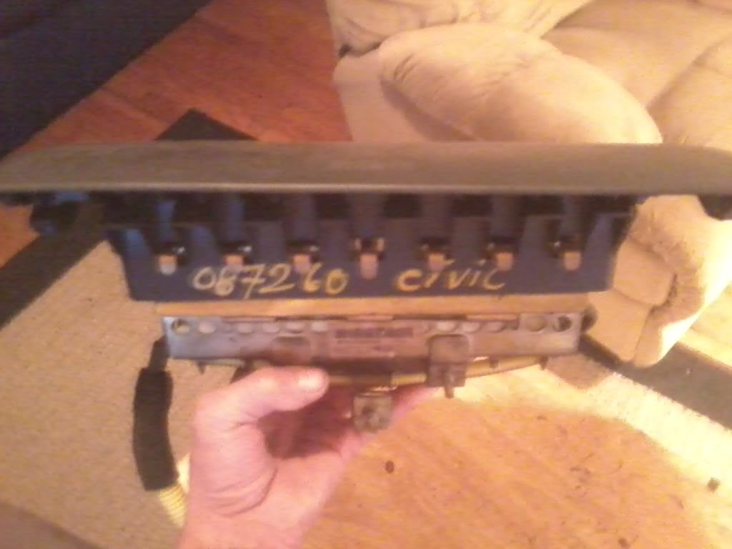

This should probably go in the craigslist/eBay thread but, I felt it was more fitting here.
$25 local CL special. They bought it for an earlier wreck and totaled the car before they could install it. lol:

Did you check to make sure you have a driver side bag? Lol.

Yeah, it's there. And you can tell it's a replacement as its a slightly different shade of black. lol
It was super easy to replace too. If I didn't have to wait the pre-requisite 3 minutes I could have been done in lees than 10 minutes. Lower the glovebox, remove the 3 nuts, pop it out, pop the new one in, put the 3 nuts back on, pull the resistor, plug it up, and cross fingers it didn't set the SRS light.
EDIT: Good news- it set the SRS light but, I just used the SRS re-set here: https://www.civicforums.com/forums/1...ght-video.html
