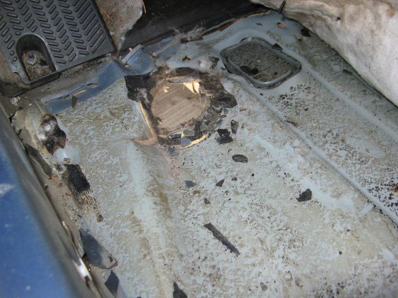

I was fixing my gas/trunk lever and realized I was able to see through the floor pan of my car.. So I'm imagining you're able to see something like this
I hammered out what I could, and cut out the deformed metal surrounding the hole, and patched it with fiberglass, both in and out of the car. After it cured, I sprayed a black rubberized coating on both sides of the fiberglass patch
